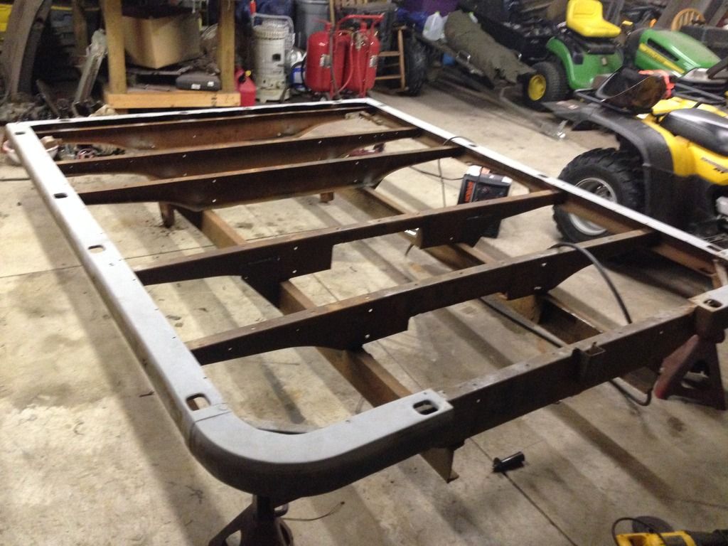

Over the last couple weeks I have been working on my trucks flatbed, now I am down to getting ready for the wood. I started removing the rear steel edge piece piece so I can slide the new boards in. I noticed there was pieces of wooden blocks between the rear rail and the rear cross member. There is not enough of them left to get a pattern to make new ones. Has anyone ever replaced those blocks and if so do you have any dimensions. Any help is welcome.

Those blocks form the left and right sides of the stake pockets, I will try to remove one and maybe take some pics, or numbers. BUT MINE are very wet,swollen. Might be a cut and fit sort of thing. Yours look just like mine,rounded outer rail
UPDATE====== 2X2X3and5/8 INCHES With hole for carriage bolt. Still looks like a cut to fit in rail.

BLIND Mine have a hole for a carriage bolt in middle.?not sure but looks like it. They maybe wedged a little Best to do metal work if any first. If block is to wide you're corners will not fit proper, I believe the rear is the last piece to go on.
mine has the metal front corners and wood side racks.

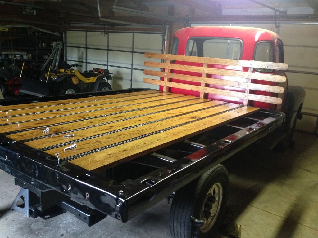

Thank you, I went ahead and used the barn wood, ripped it down and planed it smooth. The reclaimed wood gives it a rustic look I think.
http://i1062.photobucket.com/albums...F-467A-AD47-DAE91AB36B50_zpshvew4dcv.jpg
For the record on the 10 board sizes: 8 boards were 1.25" x 7.50" x 107" and the 2 outer edge boards were 1.25" x 9.50" x 107".

Finally done with the bedwood, its not show quality but it was the best I could do with the tools I was working with and most importantly... I like it. I'm going to finish installing & tightening all the bed bolts up then knock out the side rails.
