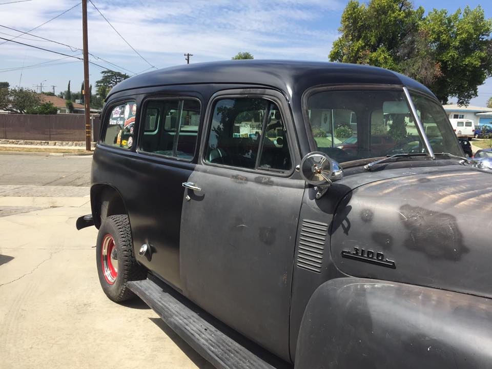

Sometimes, the back end looks a little high to me.

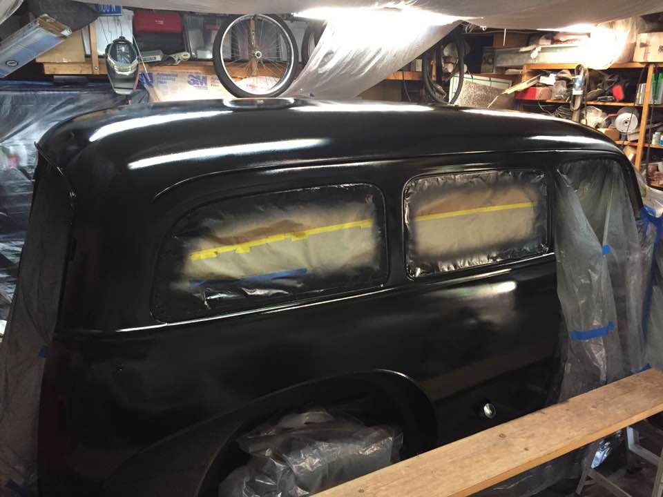

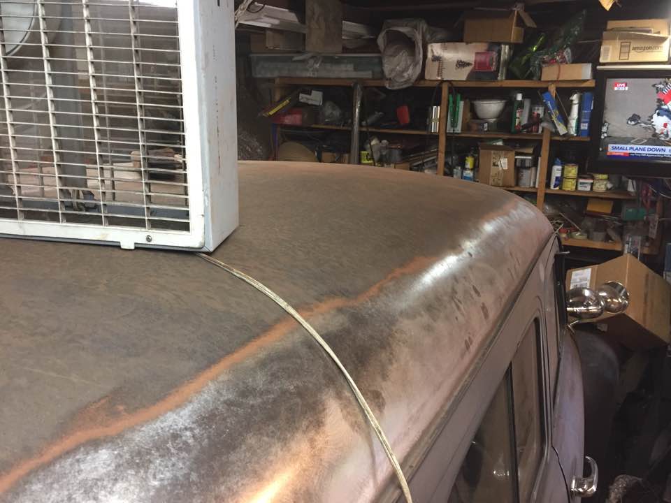

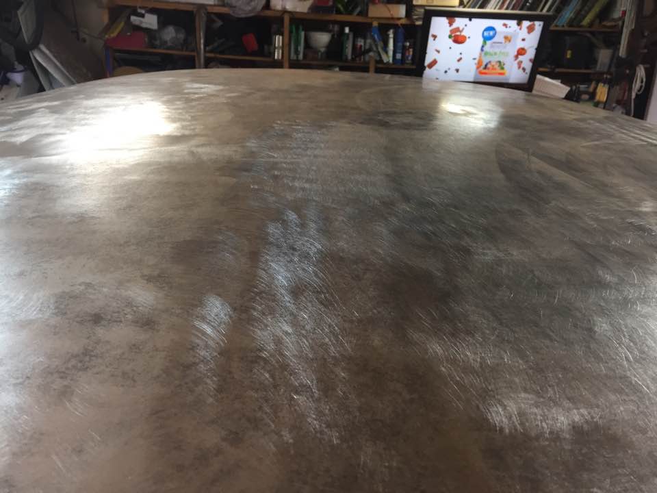

Drivers side of the roof shiny. Now, the passenger side.
....yep, keep the shiny side up smile It great following along with you. Keep trucking brother.

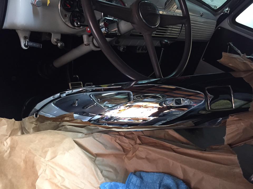

I did get the front bumper back from the chrome shop. Cost me a couple of pennies. But, finding a triple plating business in Southern California is about as easy as finding a Suburban rear fender or rear window trim. If I remember correctly, my chrome shop owner says that it costs him $50,000 a year for his copper tank permit. It also took him a little longer than he estimated, but I was warned about that. Well worth the wait!! It turned out beautiful! I'll get some pictures up here eventually!

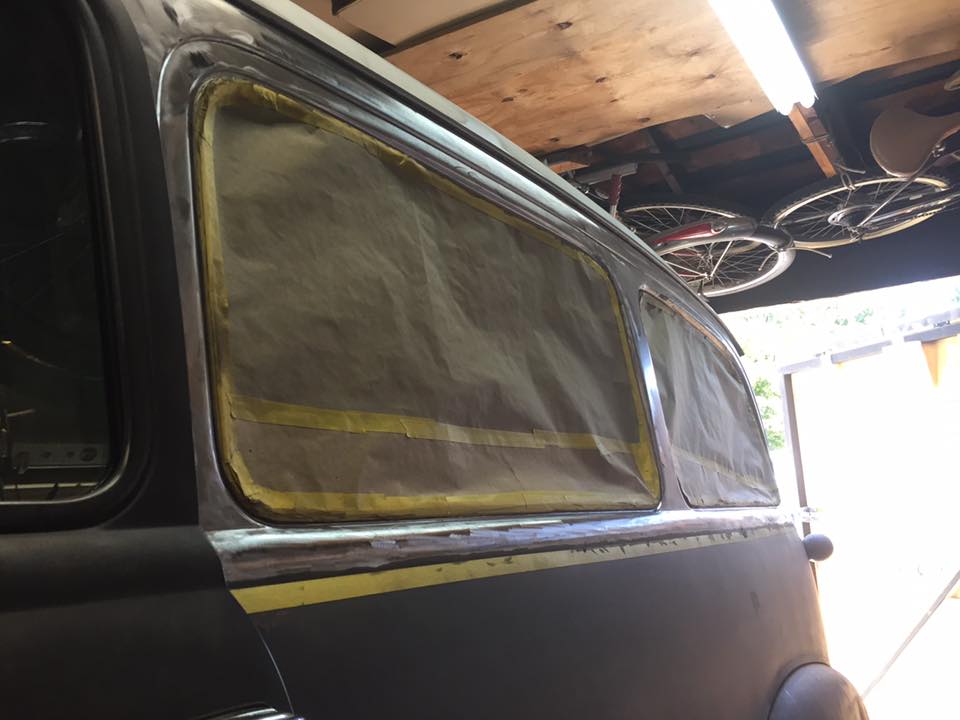

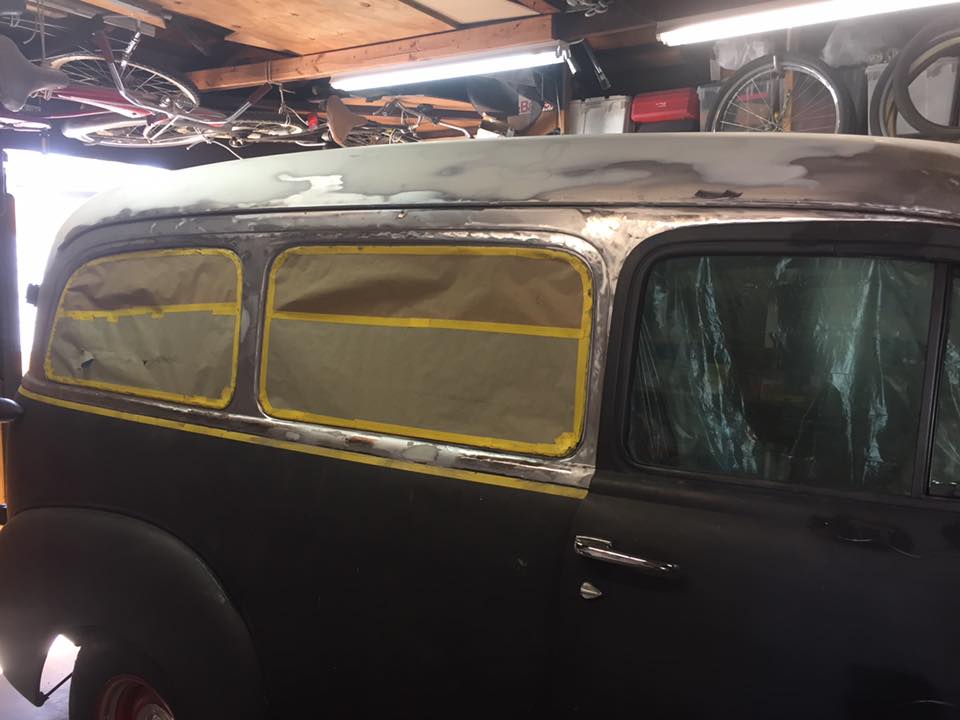

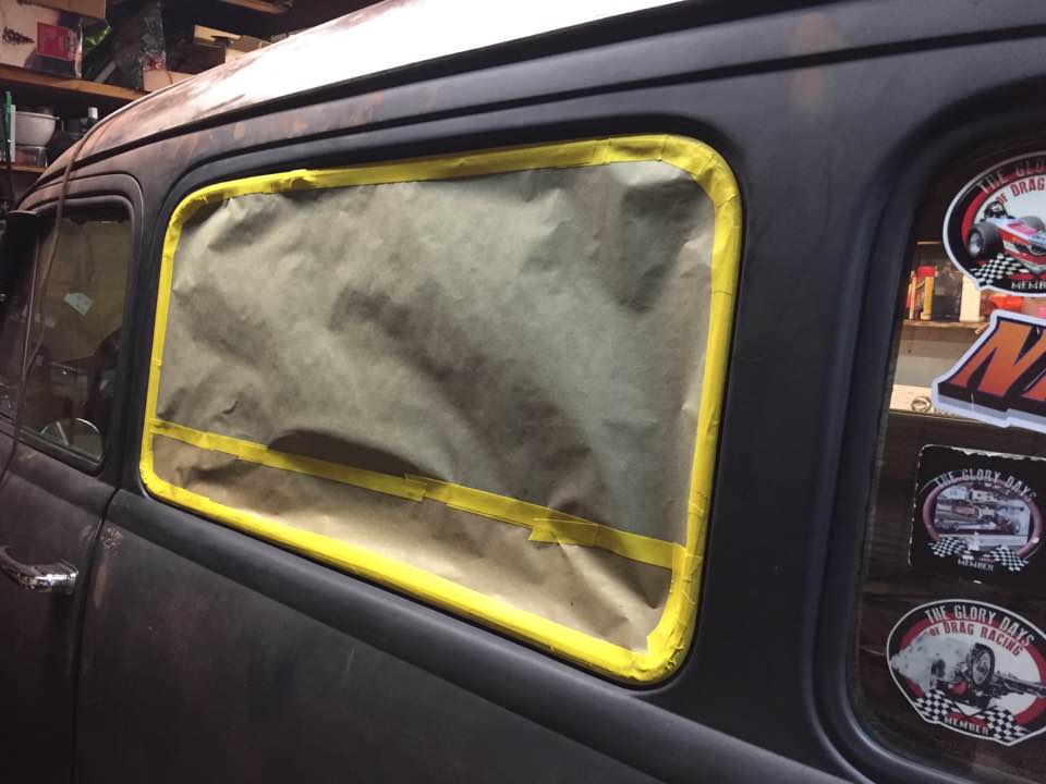

No more sanding. Time for tape! Too hot to paint this weekend. But the temps should be good next weekend!

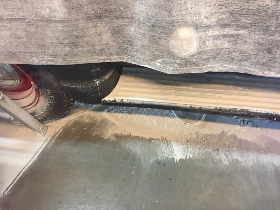

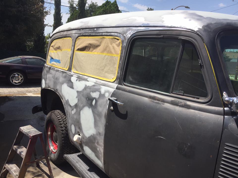

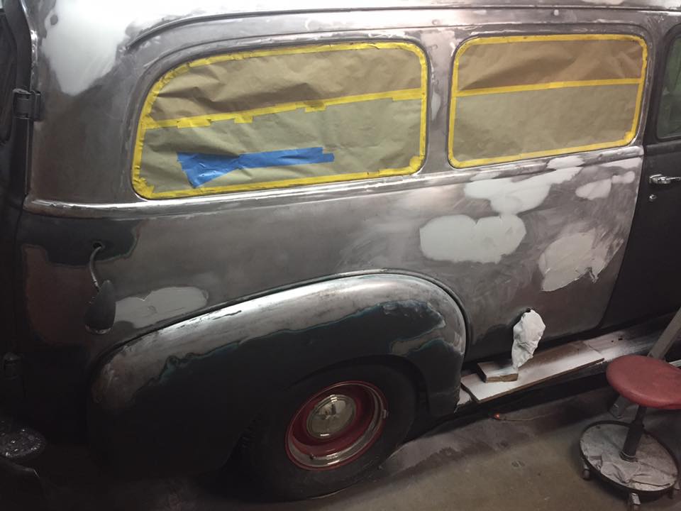

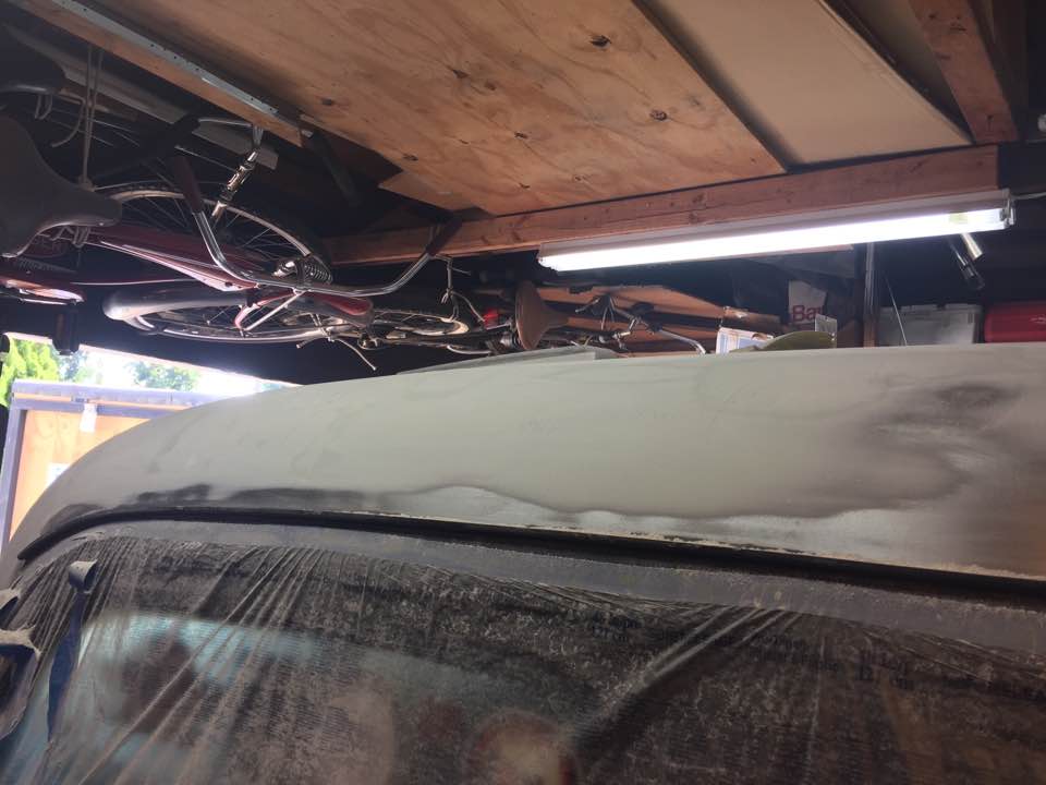

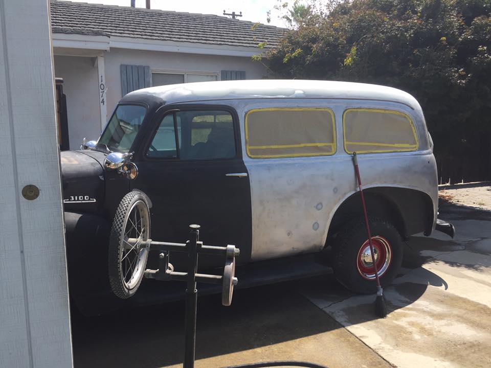

I lied. I found more stuff to sand and smooth. It didn't seem right that I would only do the roof and bring it down to the belt line. Those sides and quarters started talking to me. So now I'm sanding both quarters and the passenger rear fender. I won't even waste my time on the drivers rear fender. AND, I have 2, maybe 3 weeks maximum to get this all done.
When I do get done with this latest phase, the suburban will be in SPI Epoxy Primer from the passenger doors on back. I'll still need to find a drivers rear fender and I'll still need to repair the lower back corners as they have the usual rot.
As always, pics will follow.

Mark - what is the function of the item with the bicycle wheel?
1950 3100 5 Window
http://imgur.com/a/DAVYB
An American English wheel?
Posts: 4,252
Posts: 4,252
That is a bicycle fender roller. A few years back, when money was tight, I got in to restoring old Schwinn balloon tire bikes. Hence the http://www.bunchobikes.com web site. These days I use it for multiple purposes. In fact, I'm thinking of making a narrow (1/4" wide) wheel to roll out the dents in my window trim.

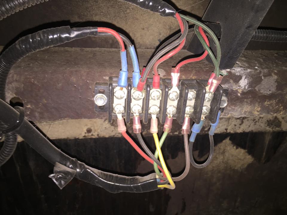

New relay for the radiator fan with better wiring. Also, connected it to a thermal switch. We'll see how that works out today.

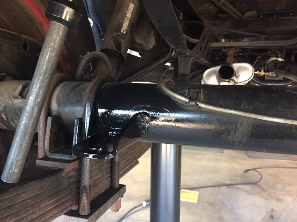

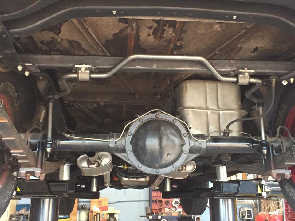

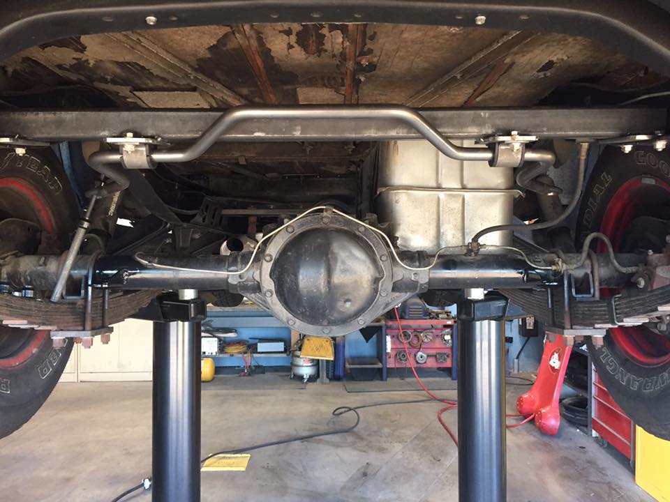

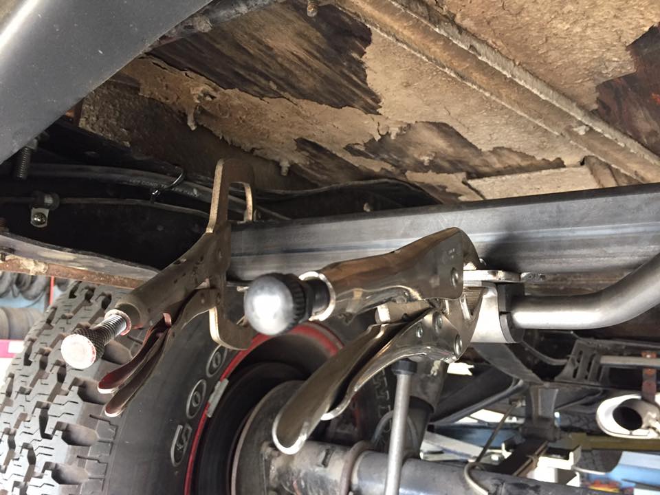

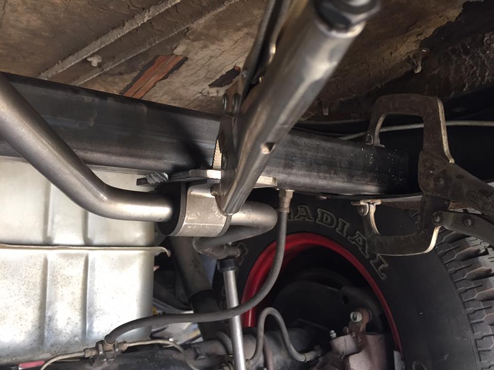

Fan relay turned out well. Turning my attention to the rear sway bar!
Posts: 4,252
Posts: 4,252

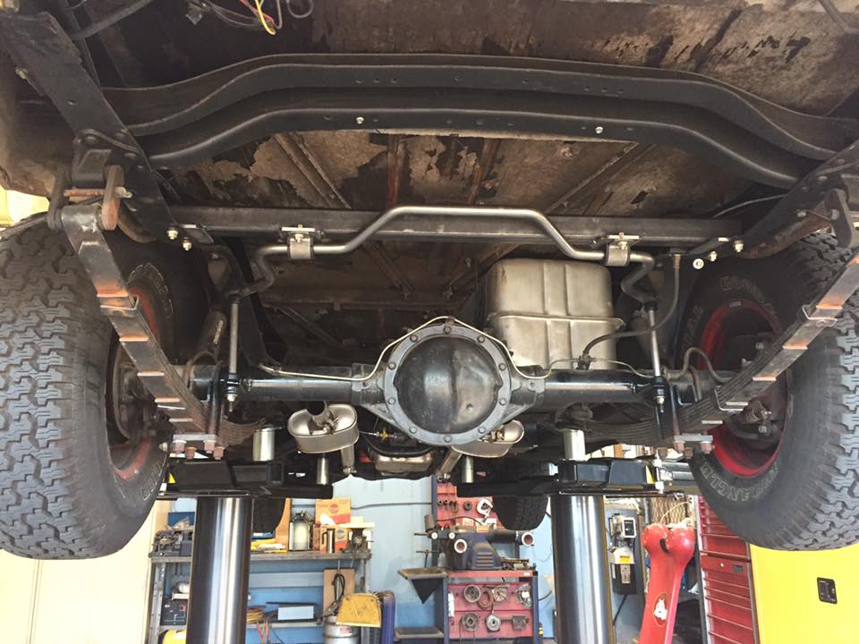

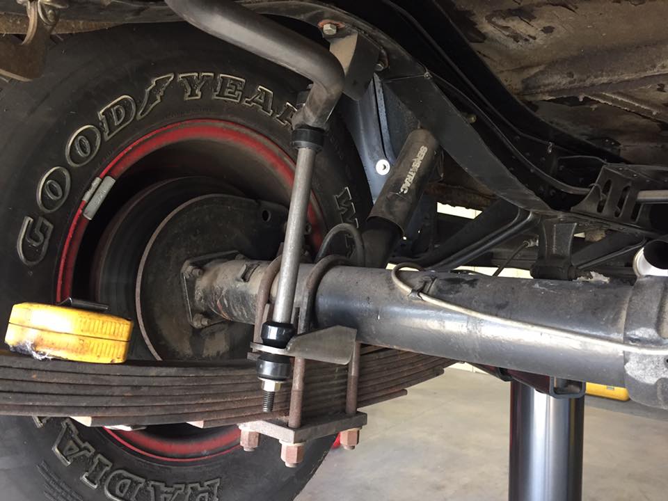

Sway bar installed. Pictures will follow. Just with the short drive home from work, I could feel a difference.

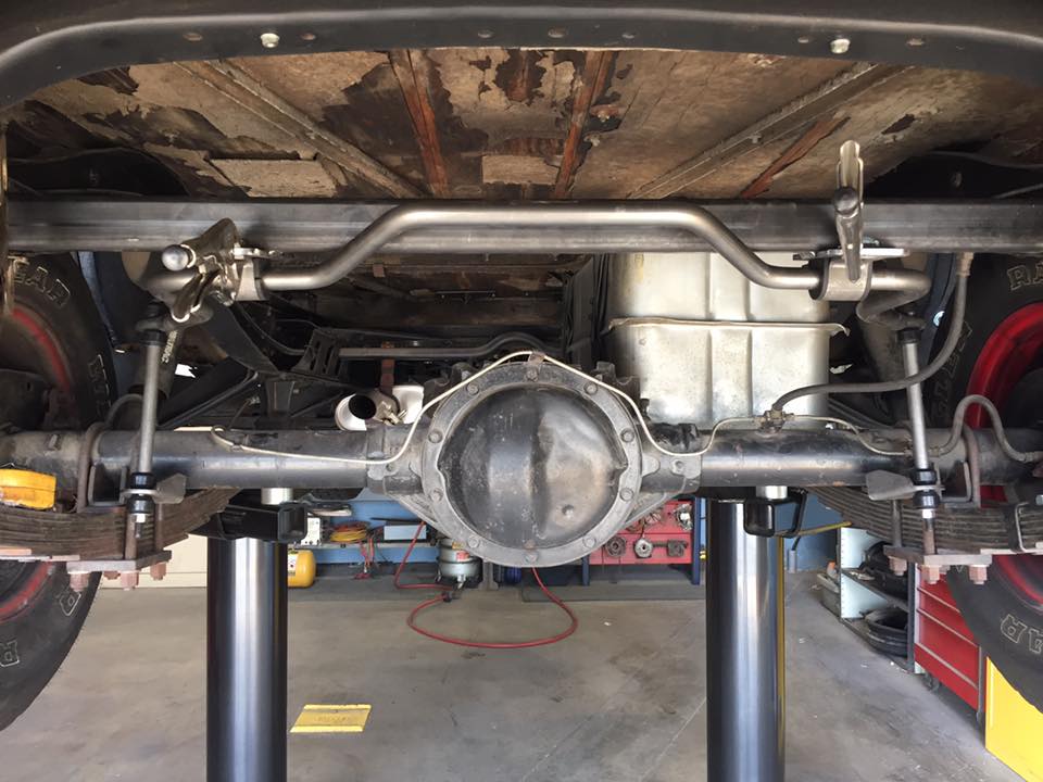

Oh, I like the way you set up your sway bar. Keep us posted later on how it works out for you.
Posts: 4,252
Posts: 4,252

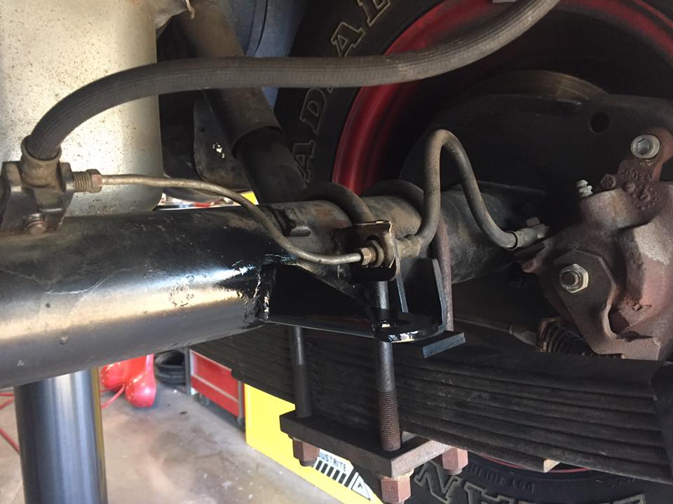

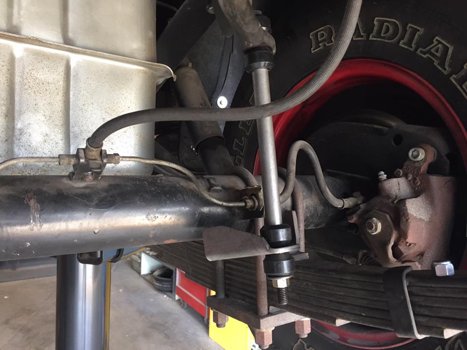

Chassis Engineering bar, made for the truck. I tried to see if I could get it to work the way they designed it. But there is just too much going on with the tank and all.

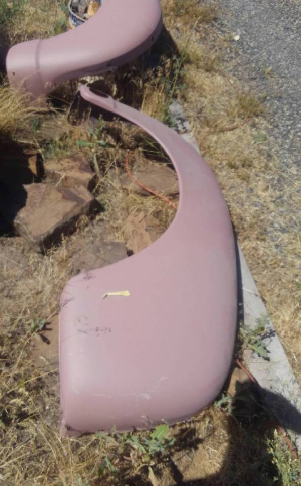

I have a pair of rear fenders coming my way. Hopefully they are in better shape than what I have now.

There are some curvy, mountainous in the backside of San Diego. The sway bar made it fun!
Mark, the sway bar made a world of difference in my Panel. Glad you have on or you'd think the top of the suburban weighed a 1000 lbs itself. Gld its working out.

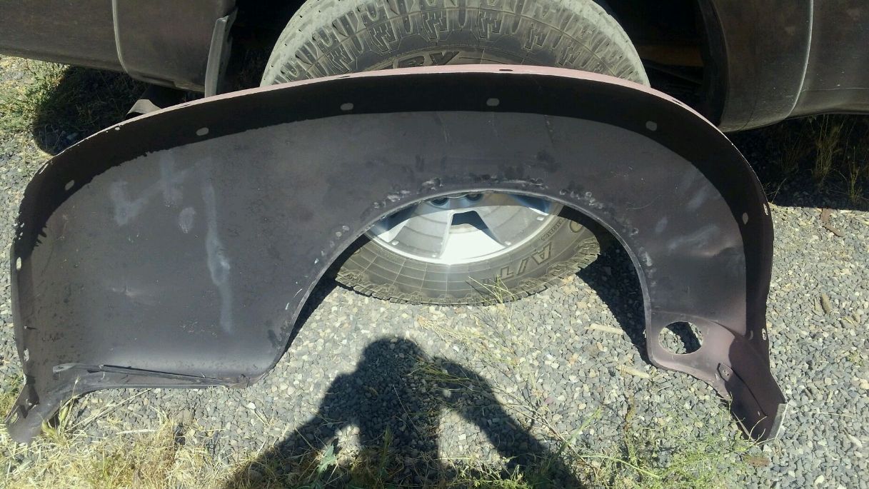

Some fender welt for my rear fenders showed up today. Hmmm. We'll see.
Posts: 4,252
Posts: 4,252

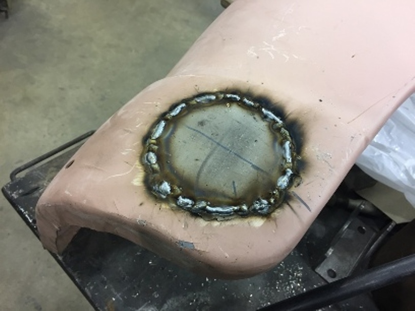

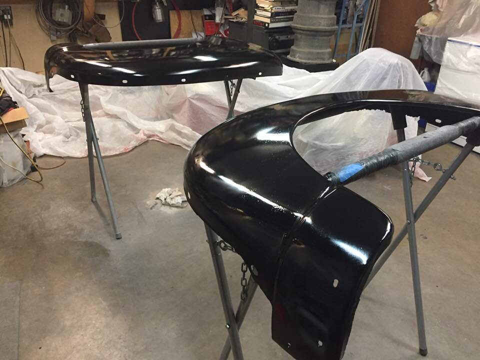

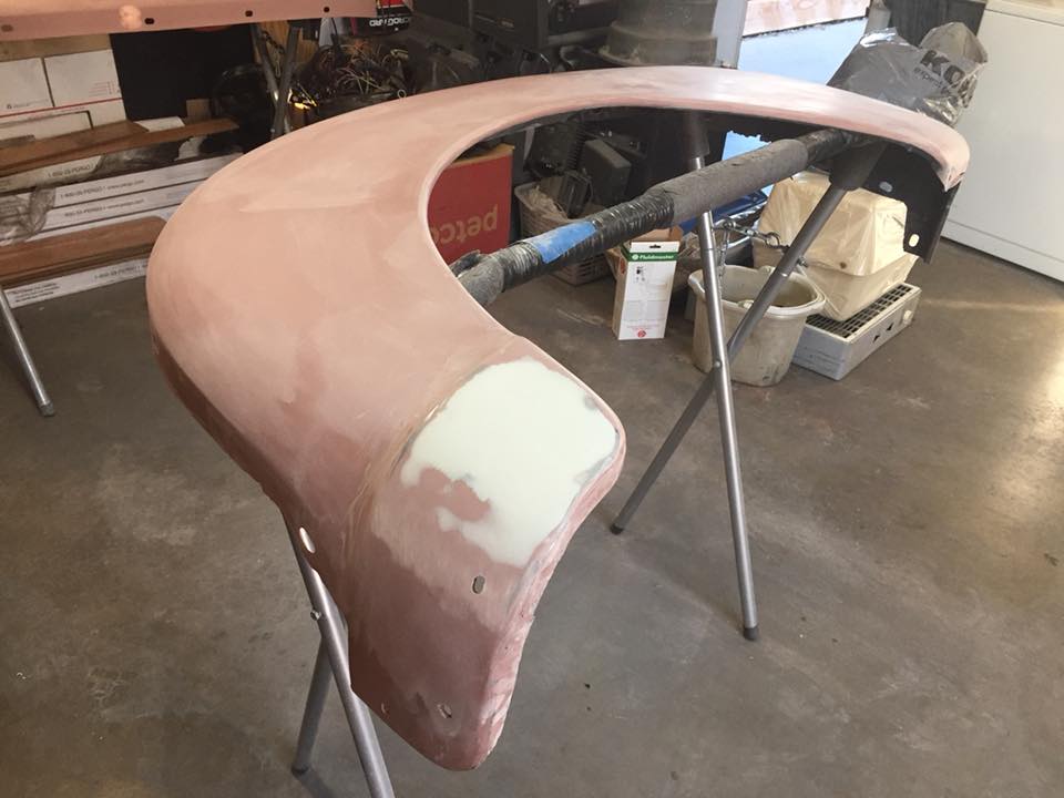

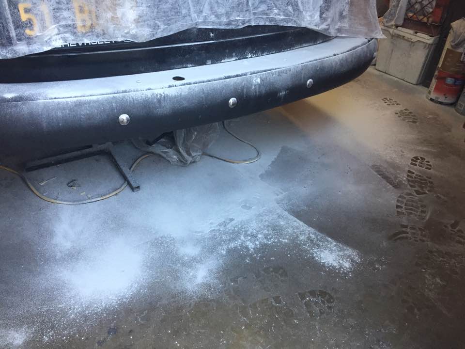

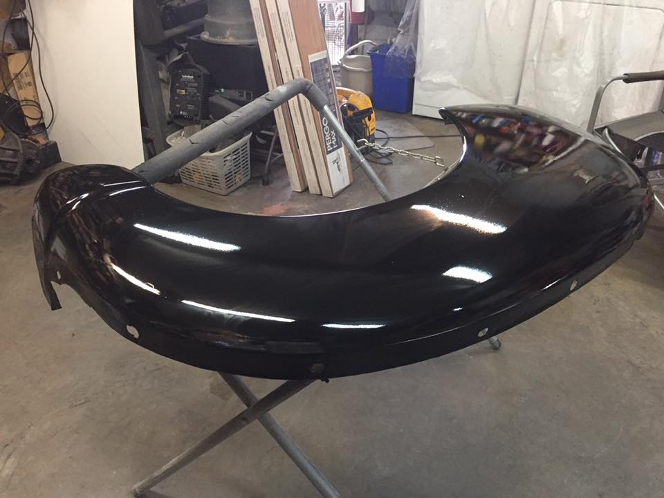

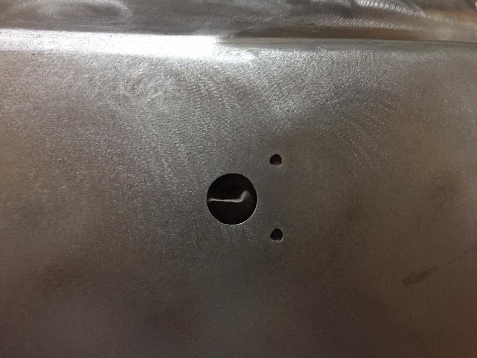

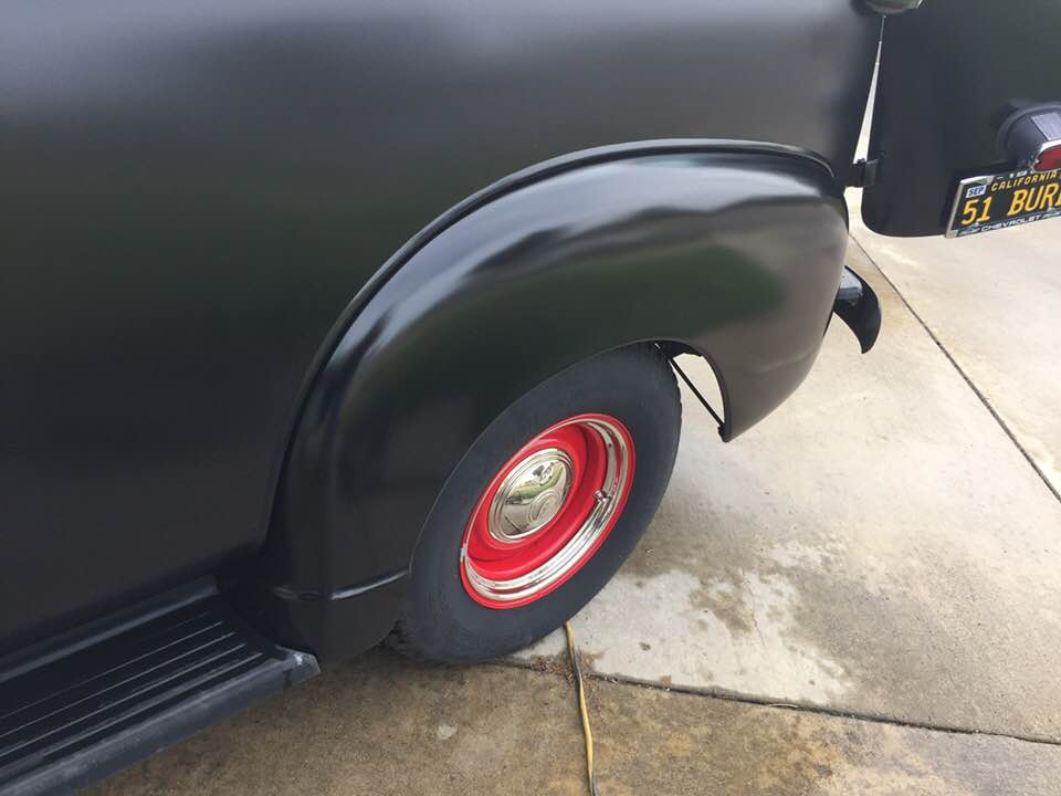

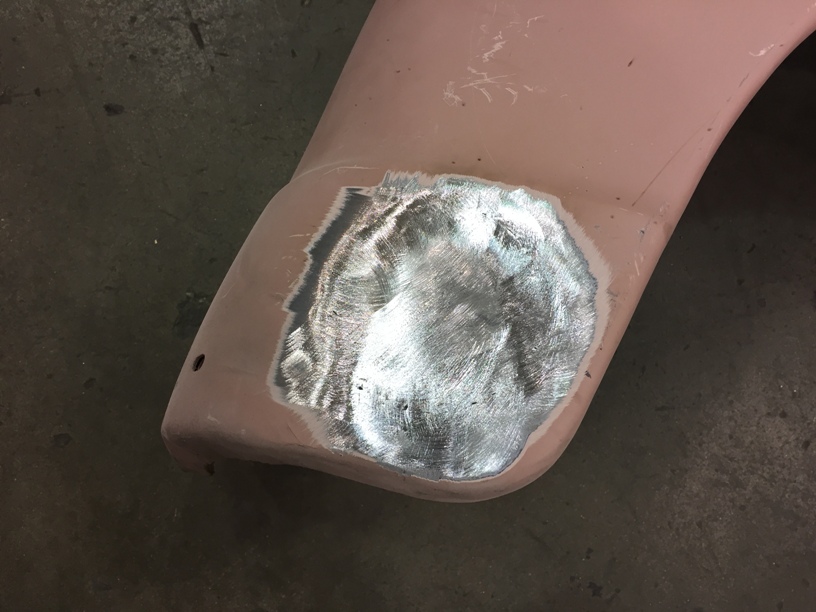

While I'm waiting for the epoxy to induce for fender #2, let me show you fender #1. No more exhaust hole, some solvent pop that was corrected, and then mounted on the Burb. I decided against the fender welt and and installed an insulating pad between the fender and the body.
http://www.bunchobikes.com/1952suburban366.jpg
http://www.bunchobikes.com/1952suburban367.jpg
http://www.bunchobikes.com/1952suburban368.jpg

Looks great!

Mark, have I told you lately your doing a great job?? Well you are. Looking good my friend. Thanks for keeping us up to date.
