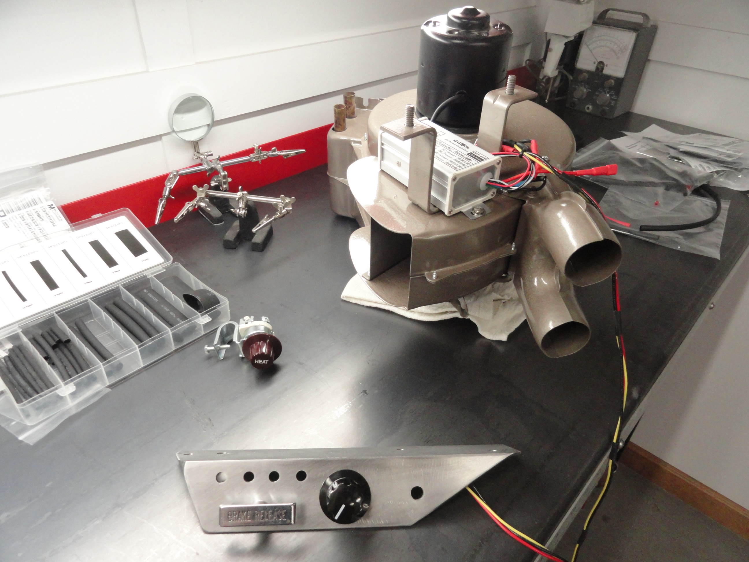

Well, Wayne started this thread a while back, to offer an
option to the dropping resistors that you can fry eggs on
under your dash or mounted in the duct work.
Ya'all gave him a real ration of sh!+ for his idea and every
reason under the sun why it was to complicated and wouldn't
work.
Using a Solid State voltage reducer sounded like a good idea
to me, so.....I invested $9.96 (free shipping) in a couple of
the DC-DC CC CV Buck Converter Step-down Power Supply Module
7-32V to 0.8-28V 12A Item# 221670461819 that he linked to.
Took a couiple of weeks to get them but they came in the
mail today.
I made a simple set up on the bench with a 6 volt Allstate
accessory heater, a 12 volt battery supply, a digital meter
and the voltage reducer. Connected them all up and watched
it run for about 15 minutes or long enough to run into town
for bread and milk this winter.
The ambient temperature today was 76° and that about where the
reducer ran for the full 15 minutes. No sign of over heating
and it is a simple matter of running 12v power to it and
running the 6v output to your load.
In my book, it's a winner and if.....I say If, I ever
converted an AD to 12v this would be my choice to reduce

Well, after several weeks absent from working on my heater motor problem, the solution finally arrived in the mail. I had done some research into alternative ways of speed controlling DC motors and the following method seemed to be just the ticket, ala moderne.
But before I explain further, the decision was made to replace the original 6 volt blower motor with a 12 volt model from a ’75 Dodge. This was part of a 12 volt conversion upgrade. And I figured that because the truck lost its ‘originity’ some years back there was no need to further antagonize myself with the existing 6 volt motor. A simple Craigslist “wanted” ad produced several quick local hits, one of which was a perfect fit ($25).
Ok, so I had ordered a couple of pulse-width modulated [PWM] motor controllers — one as a spare. These were from an eBay (Chinese) vendor who was selling them at a very reasonable price: under US$6.00 each, including worldwide shipping!
When they arrived I was surprised how well made and just how small the devices really were: roughly 4”x2”x1.5”. A number of colored wires hung out of the crafted aluminum box, as well as a small tethered potentiometer used to adjust the speed.
Testing the device was a piece of cake and everything worked flawlessly: the heater motor spun up from barely moving, through its arc to full speed. This was accomplished by the variable resistor/pot. The unit didn’t even get lukewarm while it was handling the 4.5 amp motor draw. Installing it into the truck proved quite simple — easy to stash. By using a couple of flat washers I was also able to install the potentiometer into the original ½” dash hole formerly occupied by the old heater switch. It was even possible to then friction-fit the original knob over the new pot knob (which acted as a bushing).
Here is a link to a few photos taken of my buckshee test setup complete with heater fan, and new PWM controller:
http://s525.photobucket.com/user/my_pics48/slideshow/Truck%20heater
Note: Methinks if the decision instead was to have kept the original 6 volt motor, then perhaps using a high amperage 12~6 step down buck converter as Denny tested and reported on in an earlier post (and thanks for your kudos, Denny) and then controlling it all with a more appropriate lower-voltage input PWM controller.
My install was not to suggest the defacto way of controlling motor speed. Others here have addressed this matter quite competently.
But for me it was the most elegant — and cost effective — modern variant smile

I really like what you have done here 55! I have a few questions I hope you can answer..
1) Part numbers and sources for the Potentiometer and the Controller. Found it. Search Ebay for CCM5s Motor Control. I paid $7.18 shipped.
2)The Pot has to take up to 14 watts so did it get hot at all with the heater on LOW? The most amp draw you will see is less than 5 amps, but the power consumed is 10 watts or more.
VERY elegant solution I would like to bench test myself! Thank you for sharing that!

Well, thank you for the compliment, Deve.
I'm not entirely sure what you found. But for any others who are interested, check out eBay (or even Aliexpress) & apply search parameter "DC 9V 12V 24V 48V 60V 20A Motor Speed Controller Regulator Driver PWM 25KHz"
It should give you several units to choose from.
Be sure to get something where the circuit is enclosed in a box as it will act as protection, and as a heat sink in the event of higher draws.
This is a whole different ball game from what was discussed earlier on the topic -- the pot on this PWM device generates no heat at all in any of the speeds. The tiny pot only adjusts the bias of the internal ss devices. I would assume one can replace it with a physically larger pot but with same 100k value. This might make it easier to manipulate at the dash.
..I'm confident your bench test will also prove this out as a nifty solution.
As suggested previously, coupling this device with a 12~6v step-down buck converter on a 6 volt motor could also be an interesting experiment. It may save having to find a 12 volt motor replacement. But I'll leave that for someone else to post here thumbs_up

I got the 12 volt heater motor in and spent a few hours putting it in its new home. It is amazing how nice the 12v motor fits inside the 6v case. I have wanted to update the Heater Resto article for some time to include clearer instruction on how to do this. It's updated for now, but there is more to do. With a 12 volt motor you will never run into wiring problems or heat issues since everything is native 12 volts nothing to go sideways. New content starts about halfway down the page.
http://devestechnet.com/Home/HeaterRestore

I spent the day updating the document below to include the DC Motor Controller 551stseries was so gracious as to share with us.
I tested it on the bench and it looks like a very solid way to go however there is much more to this conversation than that! I have a larger potentiometer on order with an OFF Detent, and an aftermarket rotary switch (the old 6v kind for looks) that I plan on tearing down and using the knob and bracket so it looks decent for our purposes. Lots to it, but it's mostly all here:
http://devestechnet.com/Home/Native12VUpgrade#heatersystem
Scroll down until you get to it. This controller works for both 6 and 12v motors if installed correctly! (Thanks Wayne)

I am testing 100k pots with switch so we can take all power off the motor. The BIG question is going to be aesthetics. Our target audience for this mod would not be stockers, rather those who want to do a few tasteful tweaks to further enjoy their trucks.
This being the case, and also be the case that a Rotary switch is the best way to do this, what would the KNOB look like? Right now, you can get those aftermarket ones with the word HEAT on them. They even have a light built in. A 100K pot will have no light and good luck finding a knob that allows for a light, let alone the word HEAT. I want to do this right so I am hoping I can get some feedback here on how YOU would resolve this and please the majority. Anyone? Knob shaft is .25 or 6mm, preferred outside diameter is 1-3/8" or so.
Reason for the preferred rotary is that it gives us linear control of the fan rpm.

I found a really nice 100K Potentiometer with switch allowing for the click at the OFF point. With the Ohmite 5150 1-1/2" knob (same diameter as the aftermarket HEAT ones) this setup feels like you are tuning one of those high end Kenwood audio systems from the 70's. The knob is solid so its heavy which helps add to the solid feeling and the potentiometer is smooth all the way through its cycle. I tellya, Wayne hit this one out of the ballpark! The DC Motor Controller is THE answer for anyone upgrading their heater system. No heat is generated at all on any part of the system if you go to a 12v motor. It runs the 6v motor with reducer as well (just wire it up so the motor controller is outside of the reducers influence). Very sweet! Full linear RPM control.
http://devestechnet.com/Images/Projects/WarningSystem/WarningSystem0035lg.jpg
No backlight, but if you do not know where your heater knob is maybe you need a hammer instead. I DO want to find a backlit solution though.
