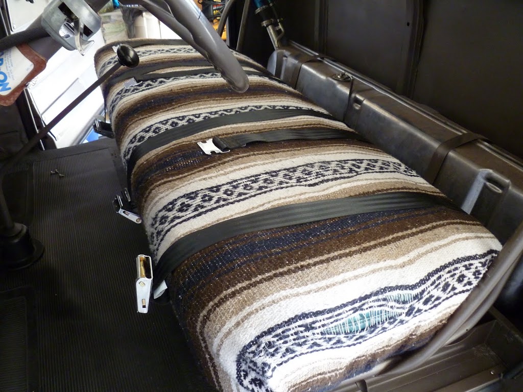

I used the lap belts from classic parts, bought them about 6 years ago. I don't recall the length. Metal buckle
...pic...
...link...
They work well, only problem is that the metal buckle gets hot if the sun hits it.. Just have to tuck it under when not in use.

Thanks Gus. These are really good pics for future reference. Steve
