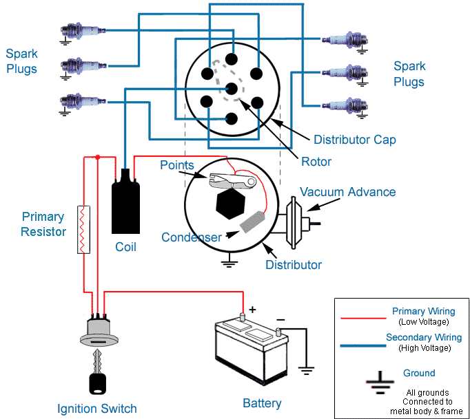

As mentioned above, it sounds like electrical. And when you mention that it started once and died almost immediately, points to a bad ballast resistor, which is bypassed when the starter is turning. This means that once you let off on the starter, no juice will go to the coil due to the bad ballast resistor.
An easy fix is to take the ballast out of the system until you get it home.

What value should the ballast resistor have? I have my multimeter with me, I can ohm it out as a check.
JFS III
Posts: 8,983
Sir Searchalot
Sir Searchalot
Posts: 8,983
Like Carl says, just switch the wire on the ballast-to-coil, to the other side of ballast for now. Ballasts do last a long time usually, but you never know. Spark check at plug gap would be first on the list. That's the farthest spark spot. Work back.

She lives again! And got me home.
I checked the fuel filter, some sediment but mostly clear gas. I need to change this, but determined I couldn't remove it without risking damaging the fuel line and emptying my fuel tank (not sure about the later, but I didn't think the fuel pump was in the tank such that there would have been no restriction on flow and it would have emptied itself as I tried to reroute lines to bypass the filter.
I checked the coil to distributor wiring. It was damaged at the distributor end and very loose. I tweaked the electrical connector and reinstalled it.
No luck starting.
Jumper-ed around the ballast resistor. Some stuttering and then she started up. Removed the jumper and it kept running. Jumper wire was a borrowed multimeter lead (all I had at the time) and I couldn't afford for it to fall off.
Drove home without restarting and was able to restart several times without any issue once I got there.
I think I need to go read up on what the ballast resistor does, when it is and isn't used and so on to test it further. Also if it's part of the coil circuit I will check into that.

Ballast Resistor, as used I our older trucks, is in the "run" circuit to lower load on points.
When starting, it is bypassed momentarily. There is a straight voltage to coil while big draw starter motor tries to take all of it and lessens the spark needed to start truck quickly. But a straight voltage/current to coil/points during driving (run) would accelerate point burn out. So they say. I've read where it is used to balance out over voltage but I thought voltage regulators did that.

1. Since you use a floor stomp starter, and an ON/OFF ignition switch, there is no means of bypassing during cranking, 2. Not sure why they thought it necessary to add the extra voltage to the points during cranking.
Remark 1. The ballast is "bypassed" in the sense that there is an alternate path during cranking. The wire from the stomp switch side terminal is a direct 12V to coil. The wire from resistor is not full 12V. So while foot on switch, full 12V is applied to coil. I guess AD's don't have stomp switch side terminal? If not, then I guess it was improved in TF to provide direct voltage, as I explained below and by HRL, as they went from 6V to 12V.
Remark 2. There is no "extra Voltage" added to points really. It's that the starter pulls so much that reducing the voltage through the ballast, if there was no other source (direct from stomp) the spark would be reduced when needed to start a cold, dry motor.

Ken, you are correct! No second wire to the coil on an AD in 12v mode. I have done a little homework along the way. That's my point! It works on an AD just fine, so not sure where the 'Improved" part comes in.
www.devestechnet.com/Images/ignitiondiagram.gif
So, I guess the spark is reduced and yet WOOHOO! Nothing happens on an AD or previous other than it starts really nice. There are not two wires. There is only one. I do this everyday and I swear I am looking straight at my system, which is the standard method for an AD, and no, one path only. If there is a REAL advantage, I want to TOUT that advantage to the AD world and let them know it is a REAL improvement. If I am wrong Ken, PLEASE tell me how, because unlike most people, there is zero, zilch, none ego or off base issues with me. Its about the truth and getting that out there so that others don't make the same mistakes.

It seems like your question is specific. "Why do you need a ballast resistor with a 12V battery and a 6V starter." I don't think anyone has said you do. That's the first thing to get thru to you. If you will read the responses. HRL said a bypass system is "available" and TC said "Possible".
A full 6V system does not need a ballast resistor (I finally got that message, I think?.) A full 12V system operates better and longer with a two path circuit, with one path as reduced voltage to the spark generating components. The other a temporary "start/full 12V" path. It does not need the resistor to "operate". IF coil does not over heat, IF other components last, IF motor starts and runs OK. Just no reason not to have it on a full 12V system.
As far as the hybrid system you ask about. A person enters into it at their own risk. The experts do not know what other components are 6V and which are 12V. They don't know if the hybrid system person used a coil that is external, internal or eternal resistive, they don't know if it's pertronix, HEI or standard, They may not care to speculate on mix and match systems. They are Hot Rodders from way back and mechanics who did a lot of tricks for the drags and such. You can't learn from them if you attack them. They don't need you OR me. You are still a "grasshopper" with a web site.
The basic idea for the bypass is described in this thread for all others to decide how they want to design their hybrid system.(conversions).
The baseline for 6V and 12V is to do it stock.

Great post Ken. Another great post completely missing the mark. Let me try to get through the cloud cover here...
When you do a stock 6 volt conversion to 12 volts, you follow how-to articles like the one found here in the Tech Tips section. You remove the 6 volt battery, put a 1 wire alternator and a few resistors in line with a few gauges and a ballast resistor (or resistor coil) and thats about it. These articles always say to use the 6 volt starter because that has proven to work. NOWHERE, I MEAN NOWHERE does it say to get a 12v solenoid switch and run a wire to your ignition switch.
If they DO say that, my problem is, why? The 6 volt starter and a properly tuned engine will start in less than one revolution, WITHOUT a bypass wire. WHY? Is it possible that because you are using a 6 volt starter, you are essentially doing the same thing as if you added a bypass wire? Anyone with much understanding of ignition systems should be able to answer this, although to be honest, not sure why many people would know unless they are running this kind of system.
This is why its dead true, Mr Lincoln gets all pissy when he doesn't know. I do not know why. I would hope this is a relatively new thing since he was a TEACHER!!
This is no small thing. When writing about ignition conversions for AD era trucks, this is a very important issue so we can all be on the same page when it comes to PROPER conversions.
For my frame up resto, there will be no conversion, everything is native 12 volts. EXCEPT, how cool would it be to not have a second bypass wire in the system because the starter is a 6 volt. (A positive thing)
I know you like to suck up to the winning team and all Ken... see it all the time, but in this case, how about we just drop the issue, since nobody knows and I will find out another way.

You keep changing the question every time the other one gets answered. Do you know you are doing that? Is it to keep an argument going?
A 6V starter rotates a whole lot faster on 12V, which rotates the motor faster and thus delivers more spark cycles. Motor fires more in the same time as a 12V starter. Motor fires more, quicker start. As far as one revolution goes, if a motor starts in one revolution, it would not matter what turns it. That's just one fire cycle.
I do not know what you mean by "12V solenoid switch". Foot switch? Ignition switch with spring loaded position or a starter with a solenoid on top.
Explaining the truth, the facts and interpreting the posts for you is not sucking up. I don't suck up to anybody. I do respect some people.

Its a start. Thats the issue. The reason for a bypass wire as I understand it is that during cranking, we need more voltage to the coil just during cranking. So the bypass wire bypasses the ignition ballast resistor just during cranking. With a 6 volt starter, as you mentioned it turns REALLY fast. But it also would put quite a bit less overhead on the system. Needing less voltage means more voltage to everything else during cranking.
So, MAYBE that difference is the same difference as if you did a proper bypass wire system on a native 12v system? I do not know for sure. Makes it hard to write about it. All I do know is without any bypass wire, it starts really quick. Makes me wonder why a bypass system was ever created. But its not apples to apples due to the 6v starter on a 12v system. I have never had an actual 12v starter on my AD trucks. You cant put one on them unless you have the TF series flywheel. Another reason to get this resolved. You see, this isnt just a matter of going to the auto parts store and getting a 12v starter. You cant without also putting a 5 TPI ring gear on the flywheel.
So what would be NICE is to get a consensus among people in the know here on The StoveBolt as to if a person shouldn't in the very least mention getting a 12v solenoid (manual foot stomper) switch and wiring it as if you had a 12v starter, complete with diagram and information as to how to do it. Its a lot of trouble for nothing if its just not at all necessary. First problem is finding people 'in the know' when most of them listen and never talk (for various reasons). Like Sam Kinneson said.. SAYIT!! SAAAYYYYIT!!
