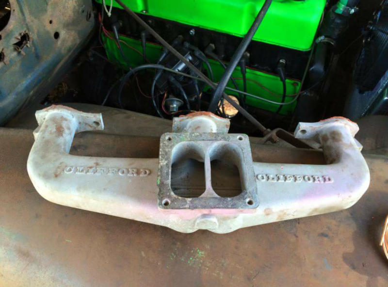

Just to be sure before i proceed because i cant find any info on this specific intake model # c5500 ... Will this take a two barrel carb? Im no carb / intake expert but the plane in the middle is throwing me towards 4 barrel?

That is the model I have that is the first generation 2-4 bbl that Clifford made for our engines. I believe the bottom although untapped for a heat plate can easily be adapted for a heat plenum for exhaust heat. I made my own heat plate on the bottom of an old period intake and it works real well.

I just got off the phone with clifford and the guy told me that this intake is basically useless on the street as it was made for oval track racing and there's no way to heat the bottom of the manifold....

That is 100% wrong. Flip that intake over and tell me if that doesn't look exactly like a stock manifold bottom (w/o the holes of course). Grigg, here on this board is a machinist. He took my thread damaged aluminum Edelbrock 216-235 intake bottom and repaired it with Helicoil inserts. I fabbed a heat plate for the bottom exhaust off of the Fenton headers.
I don't have a good picture of the bottom of this intake.... but it is exactly like your Clifford.

It does but don't have any holes in it at all

I have that exact Clifford manifold and yes, from a race car engine. They are not water cooled so they can be easily drilled by a competent machinist. In fact you could do it yourself on a home drill press. Even if you drill the two outside holes too deep, no harm ,no foul. You can just seal around the bolts. I think Clifford was just playing it safe with you.

I agree with Drew, yes, no holes, yet a blank canvas so that you can do this.

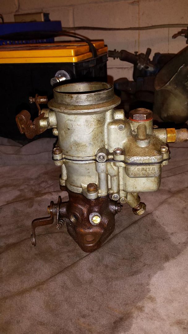

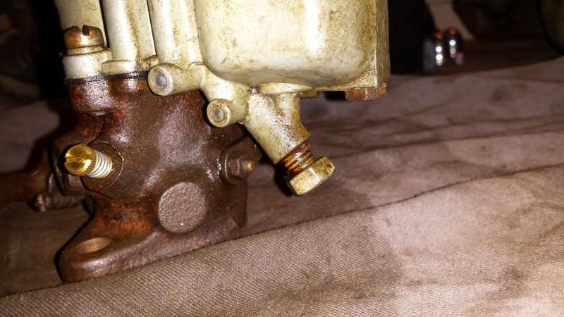

Ok I've opted to NOT install this intake. I pulled everything and my zenith is a 11147 model as shown in pics below. Is this bolt supposed to be there? ... sure doesn't look right. Also I can't get intake separated from exhaust manifold because of this 1 crazy looking bolt. .. doesn't look like the rest?
Carb
http://img.photobucket.com/albums/v678/pdinkle75/Mobile%20Uploads/20150218_182047_zpsovaesgos.jpg
Bolt
http://img.photobucket.com/albums/v678/pdinkle75/Mobile%20Uploads/20150218_182057_zpsjjebrubi.jpg

Should my carb have this adjustable main jet? Where mine has a bolt?
http://img.photobucket.com/albums/v678/pdinkle75/zenithmodel228part034475_zpsqzgctybs.jpg

The bolt definately does not belong.
Some carbs have the adjustable main metering jet; others simply have a hex plug which covers the access hole for the main metering jet. Without knowing the tag number, no way to know; and even with the tag number would have to pull a print off of a 500' roll of microfilm.

Got the original intake cleaned up and painted along with the carb.
