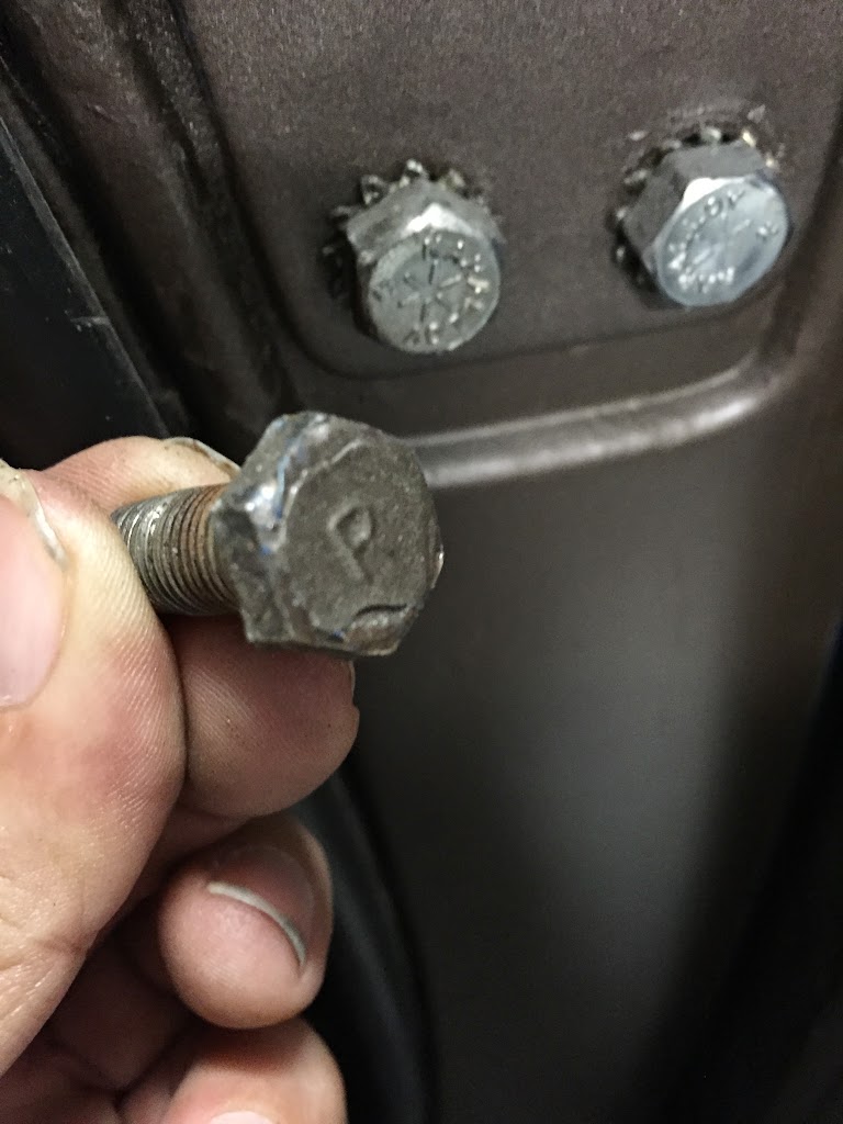

So when it comes to door hinge bolts what kind of washers do you use, split ring or star type? Also will it matter if you use a bolt where the head is just a tad thicker than the original?

AD hinges take split washers on the door, and stars on the pillar. I don't know how much clearance room there is on the pillar bolts. They made them thin for a reason.

jremig #1085909 02/16/2015 4:29 AM
External star washer
You can use a thicker head bolt

I wonder why GM went with the skinny-headed bolts. They are a pain to take off when they are a little rusty, and are easily goobered up since they have less metal for the socket to grab.
