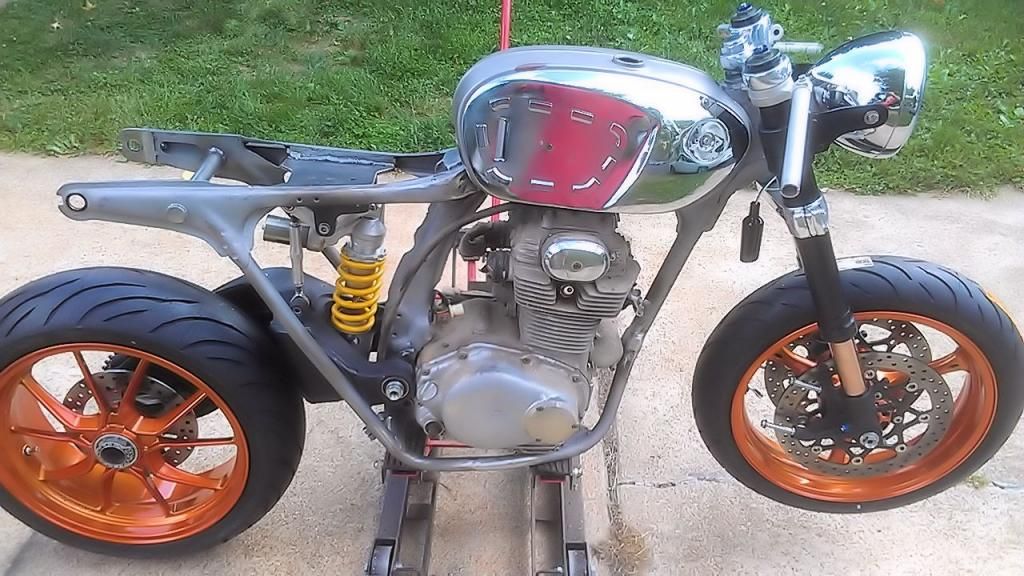

Added some photos to the bucket...various Photobucket projects

That's cool!!!
Is it finished?

Not that one....feel free to browse the other buckets...:)
