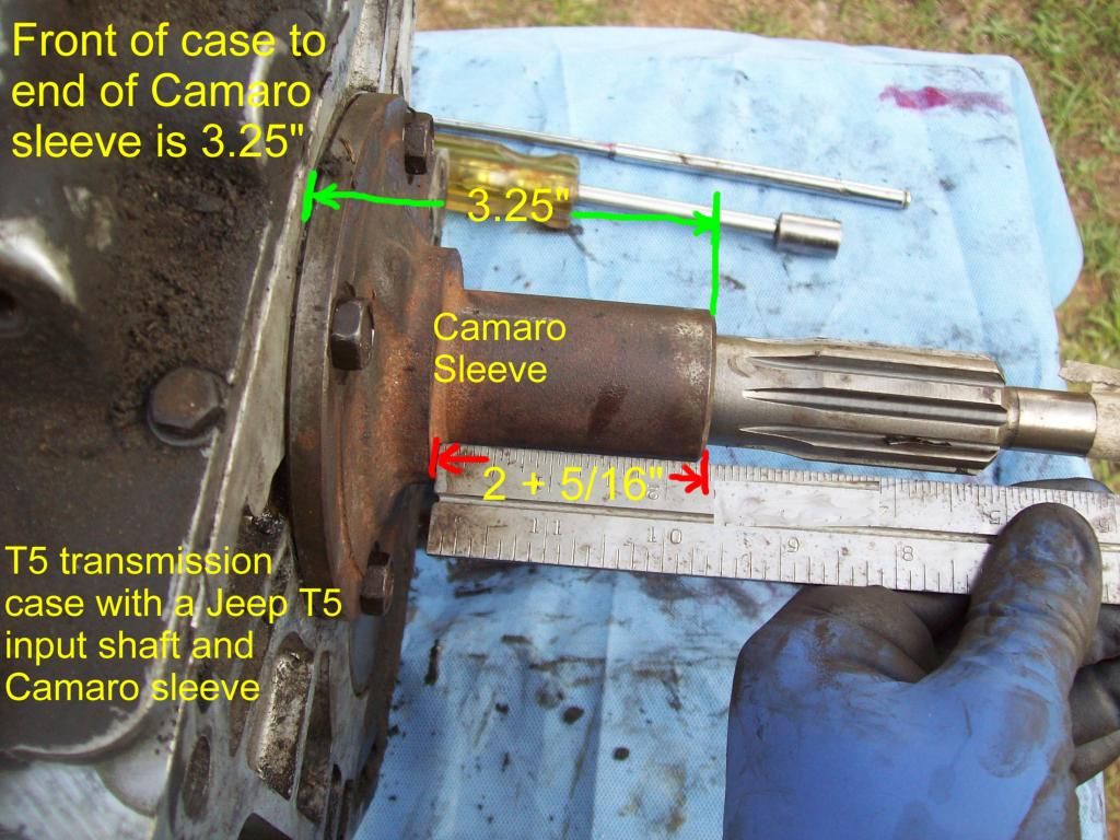

I am in the middle of installing my T5. The cab is off the frame and that means I can't test mine, but everything bolted up OK. Take a look at my BLOG -see my signature.
I'm guessing you have 14 splines on your T5 input shaft, right? It doesn't look like a Jeep shaft swap.
Your bearing retainer is about the right length. The sleeve part should be about 2 + 5/16".
Rather than cut the shaft to make the splines longer, maybe you could drill out about 1/8" of the inner splines on the clutch disc (on the tranny end of the clutch hub). Make sure the disc can slide freely on the shaft before you put it back between the flywheel and pressure plate.

The input shaft bearing retainer has a sleeve that the throw out bearing slides on. You have cut yours shorter. If I recall, you have it cut to about 2.25". That's a little shorter than the recommended length but it might still be ok.

Here's a photo of a Camaro T5 bearing retainer.
Camaro bearing retainer.
It looks like you cut the tip off the S10 shaft. Here's a photo of my 1965 3 speed manual shaft and the length is exactly the same a a V8 Camaro T5 shaft.
3 speed input shaft
The bearing retainer should be about 3.25" in total length when you measure from the face of the transmission case. Here's a picture of my original 3 speed bearing retainer. As far as I can tell, all of the older 3 and 4 speed 2WD trucks had these same dimensions.
Bearing retainer TOTAL LENGTH.
