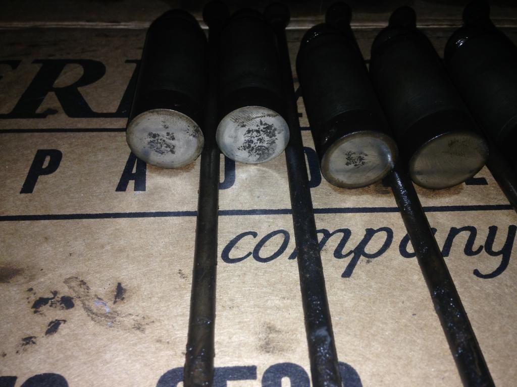

Started the tear down of the 235 in the 54- backtracking:
Engine started and ran but had been sitting for quite some time before the P.O. got a hold of the truck and flipped it to me. I replaced the brakes, fuel system and brakes complete. engine started and ran fine ( better than I though) but in doing my initial series of checks for the motor I found I had water in the oil ( here we go again) compression tested the motor before I pulled the head and #2 only had 30# (all others around 120#) so off came the head... The gasket was in good shape no visible breech and no visible cracks in hte head- but the exhaust valve on #2 was "sticky" so I'm taking to the machine shop to be cleaned, magna fluxed, and reassembled. we'll put a new head gasket in and hopefully take care of the water in the oil issue. in puling everything apart- I noted 5 and 6's lifters are pitted- cam appears to be ok. I would rather not replace the lifters if I didn't have to but I also don't want to run with the pitted lifters if it wall cause more damage- Can I just replace the 4 pitted lifters with new? or do I replace all of them? not interested in messing with cam if I don't have to (replace cam and all 12 lifters)

Pitting on the lifters and water in the oil. Was the engine exposed? You might have had some water from sitting. The lifters and the cam are not going to get any better. Rust is a very good abraisive, not what you want in the bearings and piston skirts. I would pull it apart, clean, clean and clean. It might be OK but I would not run it until it is clean

I do believe the truck sat for quite some time before it ended up in my garage- the engine is as apart is it is going to get and I'm in the process of cleaning now- While the head is out getting cleaned/ inspected/ re-assembled

What do the cam lobes that mate with the pitted lifters look like? If you choose to replace only the damaged lifters, you'll need to do the same sort of break-in run that a new cam and lifter assembly gets- - - -20-30 minutes at 2,000 RPM before idling the engine to allow a new contact pattern to develop between the lobes and the lifters, and hope the cam lobe doesn't go away. How about the contour of the bottoms of the other lifters? The bottom should be slightly convex, so a straightedge rolls over it from side to side, not flat or concave. If the lifters are flat or concave, the cam is worn out also.

If the other lifters look good, just replace the bad ones.

Those lifters are pitted pretty bad. They'll ruin the cam lobes is used. If your others aren't pitted, scratched,cracked or showing any other damage you can reuse them but definitely replace those 4. How does the corresponding cam lobes look?
Lifters are somewhat easy to replace in truck but the cam ain't.

Lifters look to be flat- but I'll check when I get back home- we are talking thousandths convex right?

The cam lobes look good at first blush but I'll take a closer look tonight

I use a 6" machinist's scale or some other type of precision-ground straightedge and place it across the bottom of the lifter, then hold it up to a bright light. If I can see daylight in the middle the lifter is definitely worn out. You should be able to rock the straightedge from side to side a little on a good lifter. This allows the lifter to spin as the cam lobe takes up the slack from the clearance and equalizes the wear pattern. A flat or concave lifter doesn't spin, and it wears quickly.

Ok. Checked the lifters- a few are slightly dished. I just ordered all new lifters- I'll just have to be careful to break them in and keep fingers crossed I don't screw up the cam in the process. Cam looked good, no galling or scratches. Taking the head in tomorrow so I've got time before the whole thing gets reassembled.
Looks like the lifters I'm getting have a hole in the body. Mine are solid. I don't believe that will be an issue. Thanks for all the input!

See if you can come up with a container of cam break-in lube from somewhere like Comp Cams or one of the other cam grinders. A package of the stuff is included with a new cam, but I believe it can be purchased separately. Coat the bottoms of the lifters and the cam liberally before your break-in run. A little ZDDP oil additive is a good idea during the break-in, also.

There are several ways to accomplish what you want to do, most of them depending on budget considerations, shop facilities available, and how long you want the engine to be reliable. Every situation is different, and there's no "one size fits all" solution.
Best-case scenario- - - -new cam and lifters, combined with a total engine overhaul, new pistons, cylinder head rebuilt, etc. Big bucks and lots of downtime.
Next option- - - -replace all the lifters, do a break-in run, and hope the camshaft survives to establish a new running relationship with the new parts. Possible, but a little risky, less expensive, and it might get you a considerable amount of lifespan before an overhaul becomes necessary.
Replace the damaged lifters and do a run-in to mate them to the cam- - - -if the lobes with the damaged lifters aren't badly pitted or worn, about the same lifespan as replacing all the lifters, less expense.
Reassemble "as is" pitted lifters and all. Hope for the best. Least expensive, also least likely to succeed.
