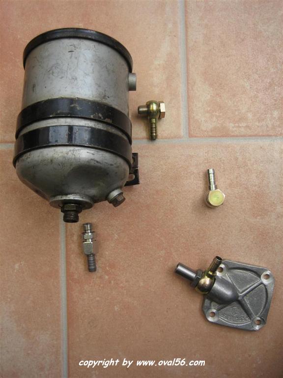

I think thats a car canister?
I bought one off Ebay like that
Has the inlet port in the front.
