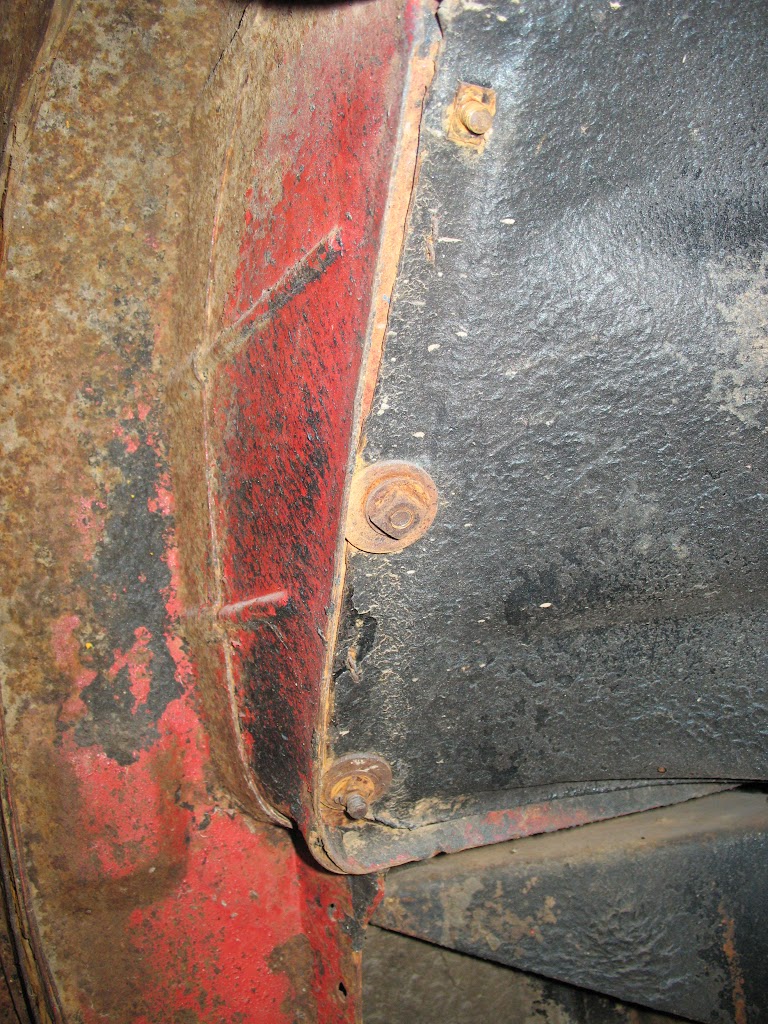

Trucks had a portion of the cab bottom treated, at least my 50 had evidence of a coating.
...pic...
Even found some remnants of undercoating on the inner fronts
...pic...
Not much left after 58 years
