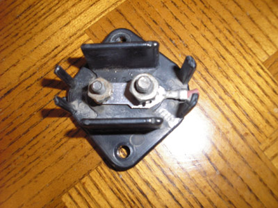

I picked up this power junction block for an alternator conversion from a newer Chevy truck (newer than mine) at the junkyard.
Power Junction Block
The flat jumper link between the two posts is tinned, probably for less corrosion and better conductivity. I like it.
Have any of you guys used these in your alternator conversions? More advice with these pleeease!

Hey, Wally
I used 2 of these to bring better power to everything under the hood and it made a wonderful difference in *everything* -- See Here

Wally/Montana,
Although I might think out of the bottom of my brain too, methinks that item you have pictured is actually a thermal link...a fuse! The little tinned strip you have fallen in love with is the fuse element.
When things get too hot in Dodge, that little tin strip leaves town. Does this sound plausible. smile

i like this find i got at the junkyard
http://i175.photobucket.com/albums/w124/rockfan1815/new%20wiring/PIC00027.jpg
http://i175.photobucket.com/albums/w124/rockfan1815/new%20wiring/PIC00022.jpg
found on many gm trucks and suvs. this way each ciruit gets its own post.
i also have one of those other terminals
http://i175.photobucket.com/albums/w124/rockfan1815/new%20wiring/PIC00417.jpg
http://i175.photobucket.com/albums/w124/rockfan1815/new%20wiring/PIC00416.jpg
not sure about it being a fused link, but cant be certain.

Thanks, Guys,
I snipped a wire from that tinned, flat link so I think it's a plain conducting jumper. I'll mount this on the firewall and use fusible links from it like is shown on the Mad Electrical page. Their power block is reasonably priced but I gotta watch my pennies.
There are a gazillion of these power blocks at the junkyard. I got mine from a truck that still had a hood on it so the block is in pretty good shape. Some showed some minor rust.
