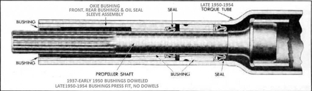

Also, my old 4.11 torque tube has its own problem. The front bushing was spinning in the torque tube, and was so loose it came out without a puller. Anybody seen that?

If you install an Okie bushing in your old torque tube I am quite sure it will fit tight. You can also pin it after installation for extra insurance it does not turn.

You can still use the propeller shaft because the Okie bushing
rear bushing will ride on a spot just ahead of the wore spot. Okie bushing Sleeve Assembly cross-section view
