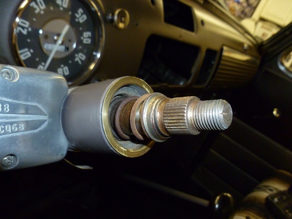

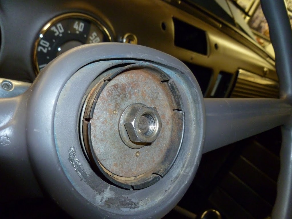

On DADS50 post above, the photo (this thing) you notice it is two pieces. On mine, I had to run some folded sandpaper between the two pieces. Then it worked fine. It was not making connection due to a light coat of rust.

Thanks for the pictures. I will go through the whole thing and make sure it is put together right. And use some fine sand paper.
