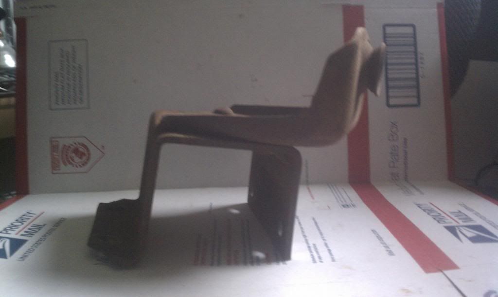

My 1 ton panel uses rear upper shock mounts as in the link.
They mount over the top on the frame with one leg and inside the frame with the other. Hope that helps.
