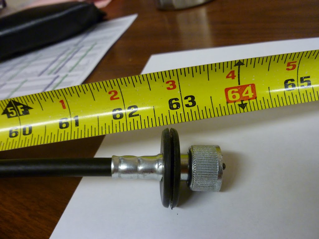

That's ...click... odd
Should look like this ..click.
...click...
So the cable came with just one connector?

The speedo part number I posted ca-3002 had the correct fittings on both ends and is about 64 inches long.
But this purchase was about 4 years ago.
