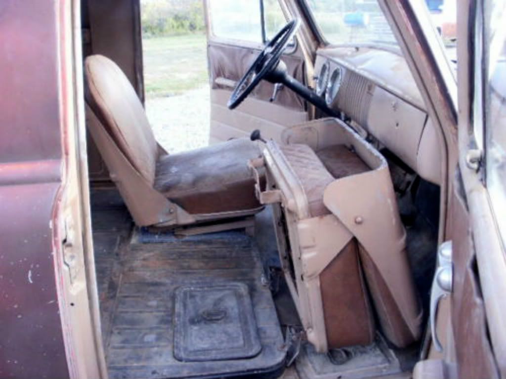

I came across this 52 GMC suburban on another truck site that i'm always on and I noticed this seat riser goes all the way across the cab.
It did not have the factory seats when he bought it so he could not confirm what seats it had.
What was the purpose of this full seat riser?

Bigger tool box compartment for panel truck.
My guess for Suburban shorter tool box riser is for easier access to rear seats.
In panel truck you enter rear floor board in 2 steps
Suburban gives you 3 steps to enter rear of vehicle.
Step 1 Ground to running board
Step 2 Running board to floor board
Step 3 Floor board to rear floor board
Carpenter lingo: Tread & Riser in stairway building.

Panel trucks came with the full seat riser to accommodate the drivers bucket seat and the optional passengers bucket seat. Panels are often called Suburbans , but they do not have side rear windows unless it was a Conversion School Bus. . The Suburban seat riser is not full cab length………..g
That green suburban was originally an Ambulance, notice the vent on the roof. They did come with bucket seats

That is kind of what I was thinking because it was ex-military. Thanks for clearing it up.

Your 2nd wide angle photo is interesting.
The only thing that makes sense to me as to why the seat riser
goes all the way across in a Suburban is what GMONIZ said it was built as a bus.
Unless someone else put it in afterwards.

I was intrested in it as well. I didn't notice it at first but when I did I asked the owner for the upclose pic of the riser because I had never seen anything like it before.
It does not look like anyone added it but I dont have any proof of that.

Notice the holes in the rear cargo side panel area that looks to be the remains of the original cabinet and seat mounts that were attached there when it was an ambulance. This was not a highly modified conversion, but a practical conversion (cheap) for military purpose.
I'd guess that it's quite possible it was built that way at a GM factory under a military contract rather than converted by an outside contractor.
Posts: 1,146
Posts: 1,146
What ever was mounted where the arrows are pointing, PHOTO
may of needed the extended seat riser for mounting purposes and height.
The mounting pattern, does not look like a factory auxiliary seat pattern.
PHOTO Check for the 2 square witness marks on the riser to the left of the riser cover door.
They are from the rubber stops on the back/bottom of the seat frame.
Then again someone could have mounted a after market seat there after the military sold it.
It just looks like something other than a seat frame was mounted there.

I have been looking for a suburban project and have looked at two that were ambulances and they both had the panel truck seat riser in them versus the short one like a suburban

I have a 50 suburban that had the same riser and it was an Ambulance. So That explains the side windows as mine has the side windows also. that is another option.
