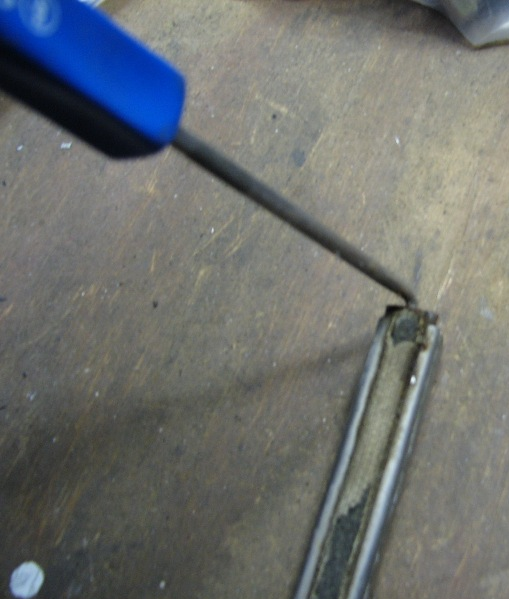

First we need to prep the new glass. I started with an angle awl. I used this to remove the old whiskers. I also used that and a small screwdriver to remove the stainless from the glass.
I basically inserted the angle awl under the old whiskers and split it open like a zipper. This seemed like the best way to not deform the whisker holder. I'd show you more pictures of this process but at this point, I had already completed my four stainless pieces.

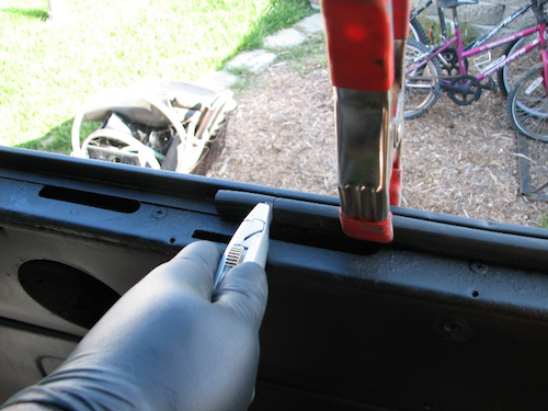

Here I'm marking on the upper edge where the old channel screws used to be.
I'm using over-sized screws because, over time, the screw holes rusted bigger. Or, at least, pulling out the old screws made the holes bigger.
Over size screws make sure that they will stay in when put in to place.
That's about an inch from the end of the channel.
Screwed into place.

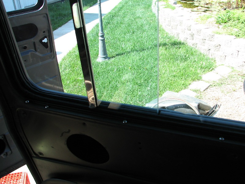

Time to test fit the slider.
When it looks good and slides good (it will be tight because of the new weather stripping), remove it one more time. There was one more screw from the factory on the top right side. I put one in the center too, just to keep the channel from sagging. (My glass might be slightly undersize so I noticed the center sagged a bit.) The slider can now go back in.
The lower moulding holder goes in.
Now the molding can be re-installed.
A rubber mallet will help on the lower half when you are installing it between the channel and the retainer. It should be nice and snug. Check the slider to make sure it moves.
