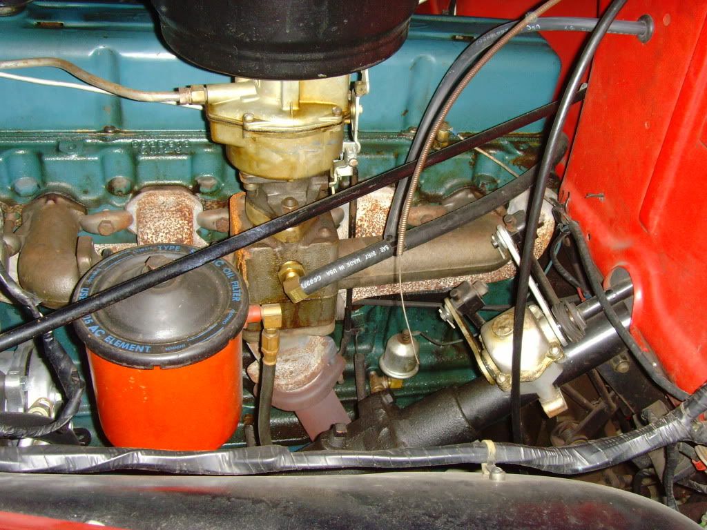

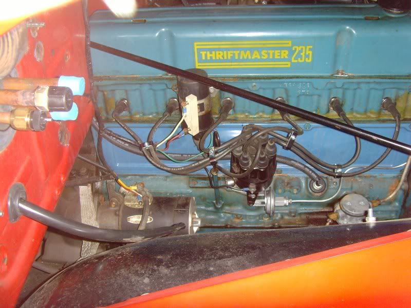

I made my own setup similar to the one from Danchuk.
I used the PCV valve from a late 70s 250 camaro. It already had the right angle adapter on the PCV valve, so I didn't need the tubing elbow.
PCV Valve side of engine
Intake manifold side of engine.
No apparent problem with it sucking the oil out of the crankcase.

Leon, I did the same thing on my 235 with parts from NAPA. Have your vacuum wipers suffered from the change? Because mine did and I switched back to the draft tube.
58' 3200 235 3-speed/OD
Posts: 487
Posts: 487
The wipers still work, but I haven't used them enough to really say whether or not there as been a performance hit.
