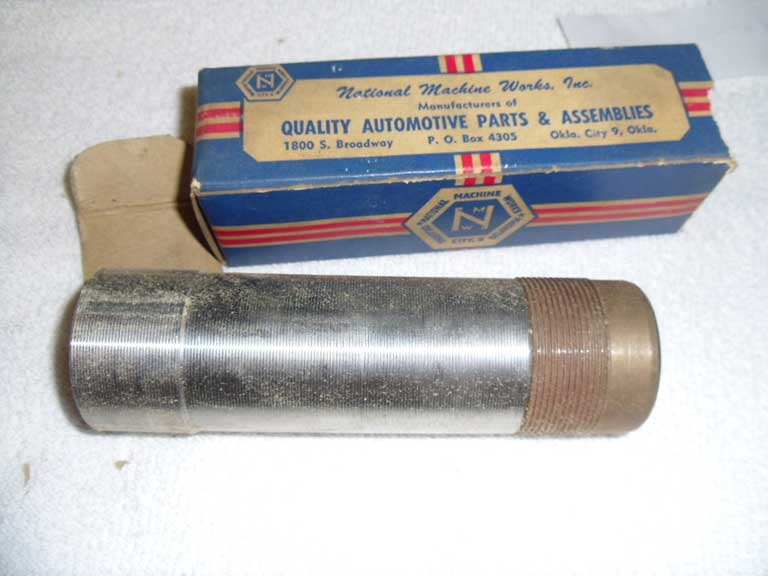

Got a friend that bought an Okie bushing for his '50, 3104
and it seems that the outside diameter is to large by
about 1/32". I see in JC's catalog that the 1940-50 and
1951-54 use different Okie bushings. Anyone have any
knowledge about the difference?

Denny,
Maybe that size difference coincides with the presence of a pin that locks the Okie Bushing in place?
Apparently, there was a third size/style?
Here's some trivia from the oldGMCtrucks.com website: why were they called Okie bushings?

Don,
I don't think I can set up a link to that thread, because you have to be a member.
let me know if this link works
this image will give a hint to the Okie name
original patent
compliments of Andy, SlimSix, on oldGMCtrucks.com

Oklahoma City!?

I had thought the name Okie Bushing was cheap shot at a cheap fix.

In 1951, Passenger & 1/2 ton torque tube,
outside diameter was increased
from 2 13/16" to 3 1/4",
and the tube wall thickness reduced
approximately .028 of an inch.
Bushing sizes,
http://chevy.oldcarmanualproject.com/parts/1929_54/346.htm

Maybe the bigger size is made in Texas...

Thanks for digging that out Tom, that's a surprise, I didn't
thing they would publish any dimensions for them in the parts
book.
I haven't seen the old or new bushings, just been hearing about
it on the phone. Another friend of my buddy was doing the
replacement when they ran into the problem with the repop
Okie bushing.
Think we got it covered now, thanks guys.
