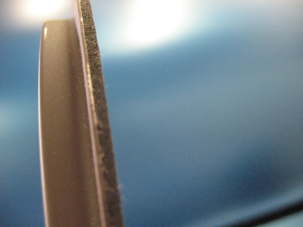

I cut apiece of gasket paper and glued it to the back of the bezel
...pic...
...Pic2...
