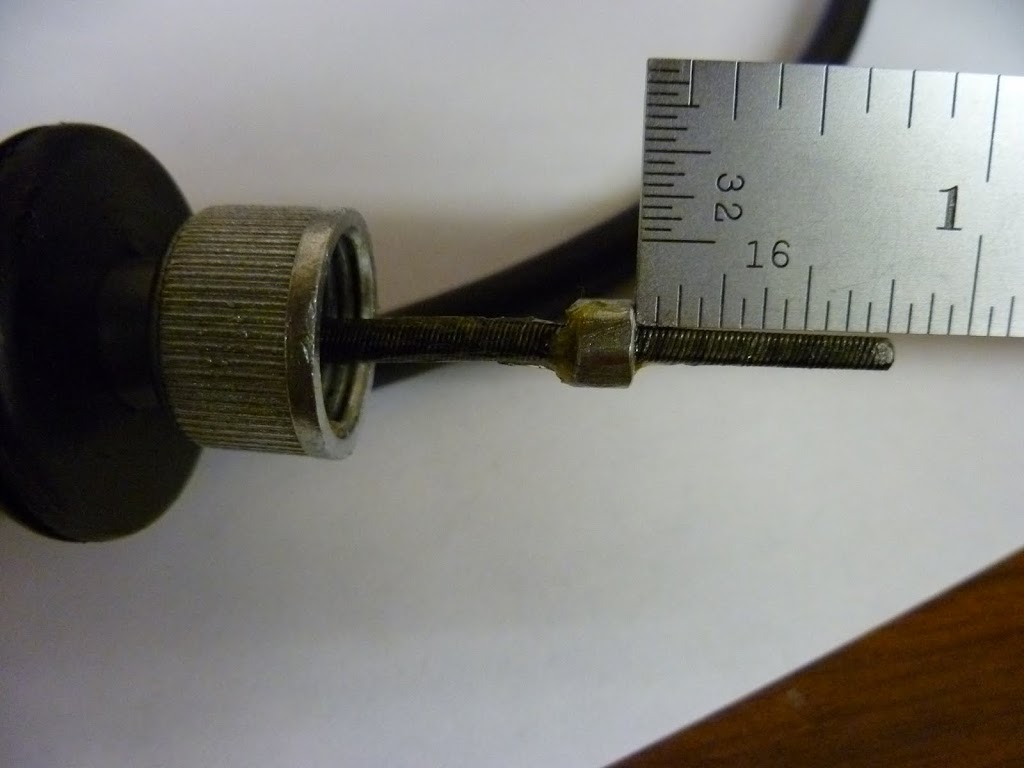

Check your cable also
I purchased one that had the square drive to long
...pic...
Inserted
Went to the auto parts store and bought another cable
...pic...
May not be your issue, just another thing to look at
