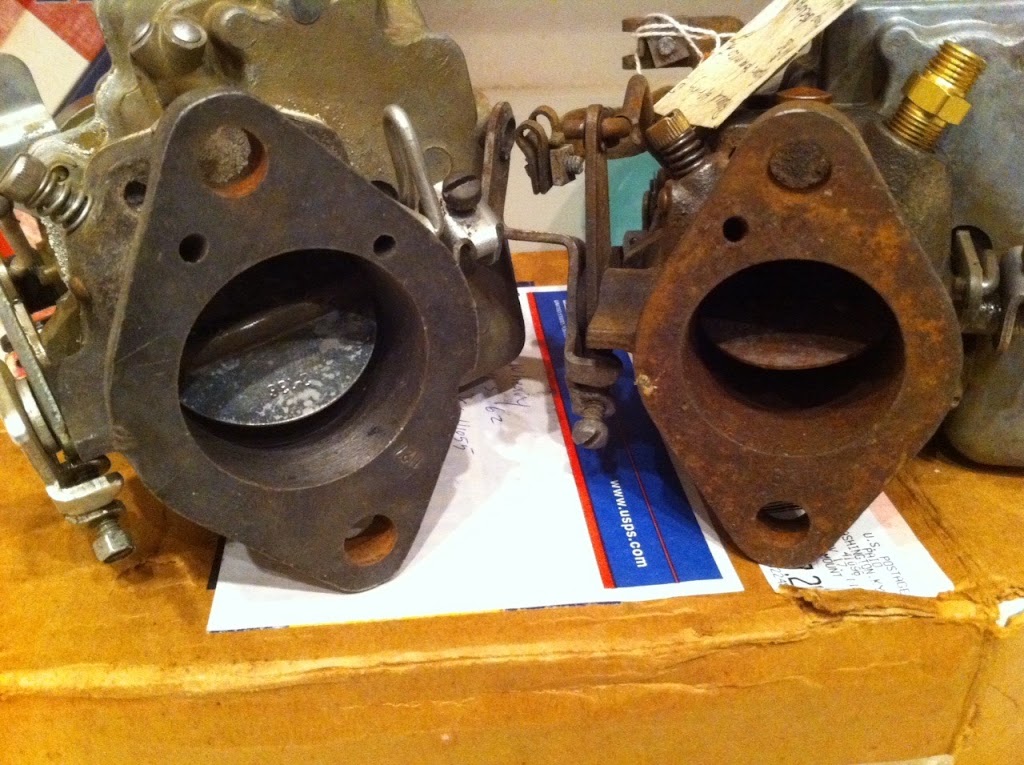

I have this Carter YF carb I had thought of trying on my 261. However, I see that the base vent hole is
opposite that of the Rochester I have on the engine.
(See the pic.) It's not a problem with the gasket, but
is with the insulator as it can't be used on the Carter
because of its location. It can't be flipped. Just curious if anyone else noticed this issue? By the way, I think this is a later carb as there is no body number I can cross check and any tag it had is missing.
Comments welcomed.

Looking at your picture, are there two gaskets below the carbs or is the one on the left the insulator? The gasket on the right looks like it would work for either carb. Are you using a gasket between the insulator and the manifold? I'm not sure if it calls for one there. But if you decide to use one there (I did on my YF), I would use one similar to the gasket on the right in your photo. The four slots should allow the air to move through. Having stated all of the above, I don't know jack about 261 intakes.

52Carl, yes, the insulator is on the left in the pic. I used one gasket at the carb base only, none below the insulator. Mark, I'll search carbking info. I think I might just mount the YF without the insulator and just the gasket just to see how it works. If not good, I'll put the Rochester back on. This is one of those "what if" moments that I had when messing around with the engine.

OK, I now can recognize the insulator in your picture. Now you have me wondering if I should take my YF off and check to see if my hole/gasket/insulator notches line up. My engine runs great and I get 17 MPG. Have you tried it as is? The gasket is pretty thick and might allow the vent to work. I'd be scared to run it without the insulator. You are likely to overheat the carb bowl and boil the gas in it.

Thanks DADS50! I thought I had looked close, but I recleaned the area you posted and sure enough a number under strong light appeared. The number is: K01 832S On the opposite side of the same flange is also a number. 7F over 5L.
So now where do I go to ID this YF single barrel carb with manual choke?
Drew

Thanks DADS50. I will save that list. But, some additional search over a second coffee, I found it is a Willys carb for a 4 or 6 cylinder according to Mike's Carburetor Shop web site, used from 1950 to 1960. Even though a Willys, I might still see how it works on my 261. Engine is in the frame, but not driven yet, so I don't think trying the carb at idle or short revs will hurt anything or am I wrong about that?

The base of the larger YF has two holes
It's the one on the left
...pic...

The Carter 832s was originally used on a 134 CID 4 cylinder Willys.
AS A GENERAL RULE FOR BEST RESULTS!!!!!
When migrating an OE (original equipment) carburetor from on engine to another, the donor engine should be within 3 percent displacement as the donee engine. 3 percent of 134 is 4; thus this carburetor might be a good choice for FOUR CYLINDER engines from 130 to 138 CID.
The 3 percent will be increased for A/M (aftermarket), perhaps to as much as 10 percent. This because A/M carburetors are calibrated much richer than OE carburetors.
Somewhere, there is a Willys guy that would love to have this carb. Or, you might get a 3x1 manifold, buy 2 more of the 832s units, and put 3 of them on your 261.
Jon.

Jon, Thanks for that info and advice. You are always helpful on this site. It's probably easier for me to find a Willy's owner than find 2 more 832S units. And DADS50, thanks for all your research too.
