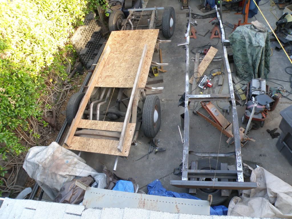

One of the best things we did, we made a drill template for the body mounting holes from the old to the new frame. The bolts dropped right in:
drill template

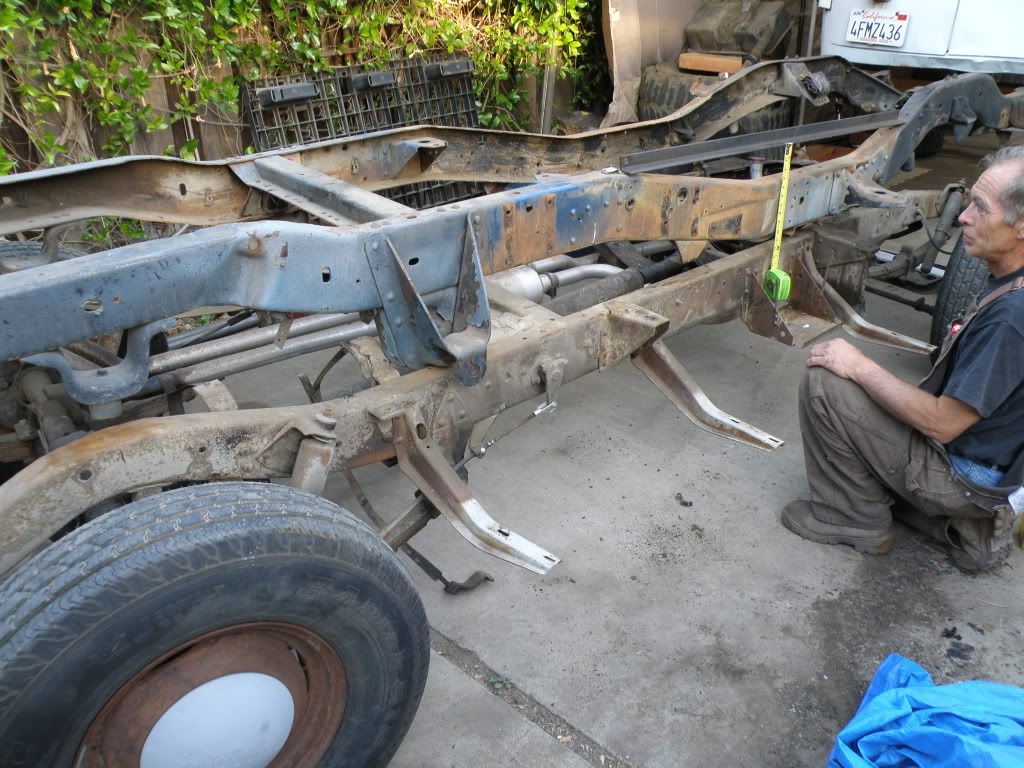

you will need to know where the frames are different:
notice the difference
