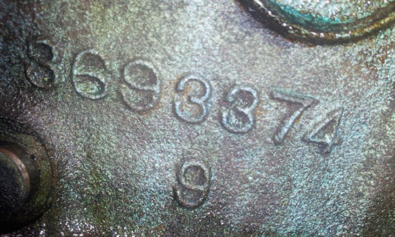

Here's the block codes: CON4 G60 3693374
Some sites say '42 - '49 year of manufacture as far as the casting number goes, but we can't find a G=July 6= 6th, 0=(YR 1950?) block number that correlates with 3693374 on this 235.

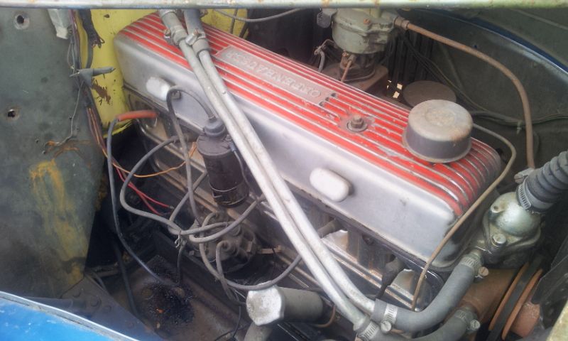

The head has a finned Offenhauser valve cover. It appears to be OEM with the worn red paint and Offy scripted logo. Other than that, the 235 is bone stock.
If we get the engine to turn over - we'll be in the plus column. Before we attempt to roll the crank and get the pistons moving, we'll be checking in with the Forum for pre-start tips to avoid any damage - or we'll just pull it apart and see what we've got to work with.

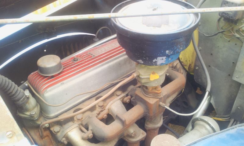

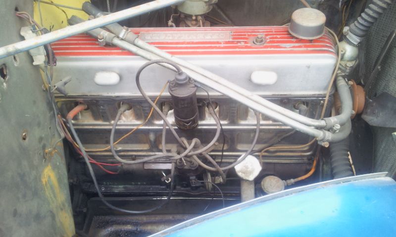

Can you post a pic of the whole engine, mainly the pass side?

Dave, We'll get them up in the next day or two. Tks, Rob

Boy do you have an interesting engine!
The big O with 48 in the center, between the distributor and breather tube, was used on 1948 and 1949 216 engines.
The casting date is a bit of a mystery.
Even if someone bought a replacement engine in lets say 1950 (the casting date) I would think you would get a 1950 engine with out the 48 in the circle.
Has me scratching my head.

Dave, this is your text from 21/02/06 on a similar question about the circle-48 marking on the engine block:
"The 48 seems to be a carry over from 1948. It is strange it was not changed to 49. In 1950 there is only the big circle with nothing in it. These were the only three years Chev used this casting mark."
What we have so far is:
(48)
CON4 G60 3693374
9
The (48) lines up right above the 74. Would the solo '9' below the casting number under '33' shed any light on this mystery motor?
Tks, Rob

My guess on the solo "9" on your block is it's the sand cast mold number. They numbered the master molds so if there was a defect after the engine was cast they knew what sand mold to look at.
Mike B smile
