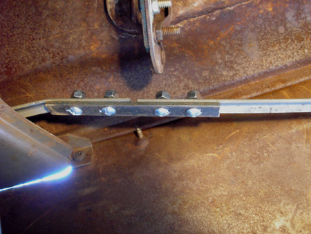

I don't know if this is your problem but when I replaced my vacuum wiper motor with an electric one from LMC, I also got a linkage problem that I couldn't correct with blade positioning. I can't remember the symptoms exactly but it seemed that one arm was too short.
See the picture. I cut a piece of metal and put 4 slotted holes in it for adjustability. I then got brave and cut the arm and put round holes in it. Turns out that lengthening that arm solved the problem.
Adjustable wiper arm.
