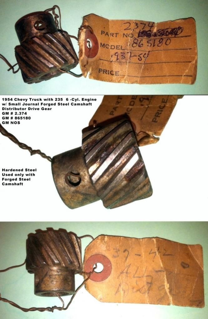

What's the best way to clean this old GM nos Distributor Gear ?
Engine: Early 1954 235 6-cyl. with small cam journals Forged Steel camshaft.
So, the distributor gear is hardened steel to match the cam.
See: PIC
http://i669.photobucket.com/albums/vv57/glp0329/DistributorDriveGearGMNOS_zpsfb522666.jpg
I'd like to use this nos gear but don't want to hurt the fit on the distributor shaft.
Any suggestions appreciated.

It looks like a protective coating more than rust. I would soak it in lacquer thinner than scrub with a brush and see how it comes out.

Soda blast it.

its cosmoline, if the lacquer thinner doesnt work try boiling it off in water. it only a wax protective coating.

If its hardened steel, why not clean it up on a wire wheel on a bench grinder - or as I call it, "small parts slinger".
