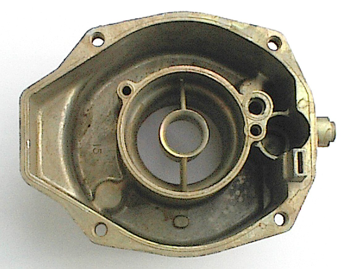

The Rochester type B will eventually warp due to insufficient screws holding the airhorn to the bowl. This will cause the power valve to always be open, and the engine will run extremely rich fouling plugs, washing oil from rings, and extremely low fuel mileage.
Approximate mean time to failure with either new or straightened castings - 5~7 years.
Straightening of the casting is done by heat and pressure. I have discussed this before on these forums. For step by step, please do a search. It is VERY labor intensive. If this must be done professionally, VERY expensive.

In the Model B portion of Doug Roe's Rochester carb book (first printing) he mentioned that some of the earliest model Bs did have some problems with their airhorn castings warping, But he says a design change corrected this problem and subsequent models were trouble free. Having never had this problem with the several model Bs I have owned (all passenger car '54 and later), I would think simply sanding the gasket surface flat would be sufficient. How much do they warp? Never had a Carter YF, only a set of YHs and some WGDs, I think they are all a related design that uses metering rods and diaphram accelerator pumps. I like the metering rod system but am not a fan of diaphram style pumps. Over all I would prefer the model B (but I just dont like their nasal sounding part throttle whistle when used with unsilenced air cleaners). My two cents.

The early B's warped in a couple of years. I was referring to the newer design at 5~7 years in my previous post.
Sanding the edges makes the problem worse, as one removes metal, plus removes the ridge that helps the seal.

And Ed - here is a picture of the "ridge" used to help seal the gaskets. Sanding and removing this ridge will guarantee issues:
http://www.thecarburetorshop.com/Rochestersealingridge.jpg
