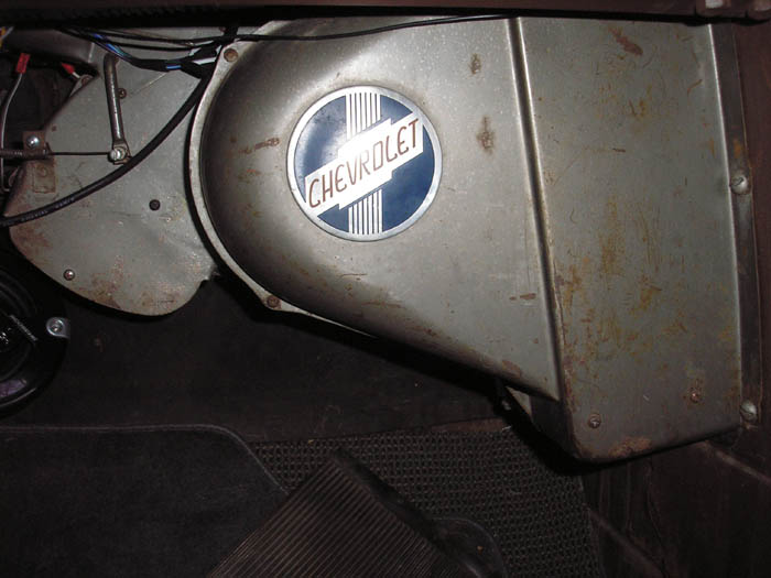

Here's a picture. Heater.

You have to remove it from the truck to get the motor out.
Removing the front cover only shows you the cage

That's a fresh air heater. Just remove the entire heater and if you are not rushed I would break it down and rebuild it. That way it will give you many more years of service. If you need to replace the motor many vendors carry both 6 and 12 volt motors.
