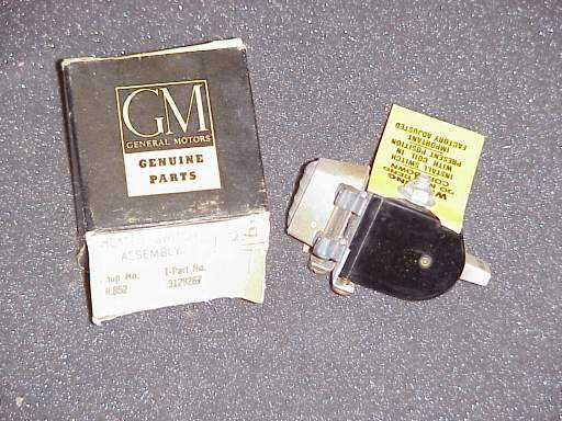

Tex: The original heater switch is a brown plastic switch that has three positions on a flat brown plastic toggle that goes up and down. The maroon replacement switches with a rheostat type of setup are not original and are not what came on the truck from the factory.
Here's a photo of similar switch. The difference in the original is that it is brown toggle with "heat" on it instead a white toggle with "air" on it.
[img]http://www.oldgmctrucks.com/photos/stovebolt/heaterswitch.jpg[/img]
It mounts under the dash between the defroster cable knob and the column.

Whoa! Ooops! Correction!
This is the switch used on '47-'53 trucks. The '54 GMC (and "'55 1st series" GMC)had a toggle on the dash above the radio and to the right of the guage cluster, in an odd spot.
I am unsure about how Chevy truck heater switches were set up on '55 1s series. I know that it is a two speed (three position w/off) switch because I have an original '55 1st series Chevy Truck data book, but as far as the type of switch, I am now uncertain.

hello all. just ran out to check the switch on my 55 first series chevy and it is the same as the one in the picture and is mounted to the left of the steering mast. the word air is printed on the toggle.

Thanks everyone! My switch looks like the one in the pic but I will have to look closer to see if "air" or "heat" is imprinted on the toggle itself. I have seen replacements that have a rotary dial, these must be aftermarket. I think I will try to use my existing switch after switching to a 12V motor. The current should be approximately halved and therefore the power dissipation from that ceramic/wire-wound resistor should be one fourth of original (power = current squared times resistance)
