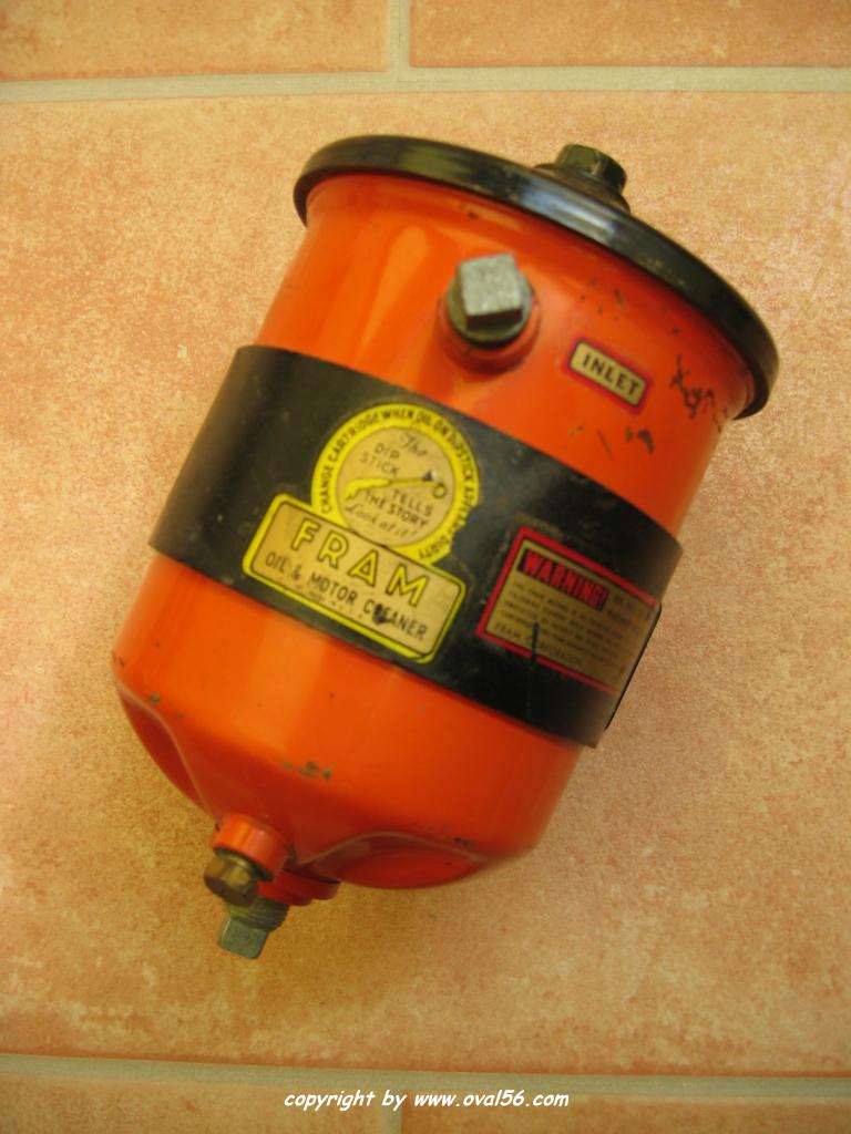

Can someone help me figure out what this filter goes to Yr/vehicle
Thanks for any help
http://i1255.photobucket.com/albums/hh624/dkrenik/001.jpg
first time trying to post a link to photo hope it works

crash2012 - Guessing from the colors, that's a Fram filter housing. Looks really tall for a typical 216/235 bypass filter but it could just be the angle of the picture.
http://www.oval56.de/zubehoerpic/030807%2003.jpg
http://photos.imageevent.com/mrokrasa/holdingphotosalbum/websize/oil%20den.jpg
You might ask on the forum I've linked below. They have an entire section on bypass filters.
http://www.bobistheoilguy.com/forums/ubbthreads.php?ubb=postlist&Board=34&page=1

That does look like an extra long filter. It is a Fram. You might check to see if filters are available for it.

Healingbear I couldn't find it in the tech tip section,yes it is taller than those in the pictures its app. 10 1/2 inches from lid bolt to bottom, I regestered on BOb's oil forum so i can post there tomorrow,

Ok it looks like a Fram cartridge filter 1950-1960? maybe for larger trucks 1, 1 1/2 tons? filter could be a Fram Cp4
If anyone could add too this??
Thanks
a Fram C4P is roughly 4 7/8 tall and 4 1/4 diameter
I believe that filter will be to short for your canister.
do you have an old element you can measure? maybe take to NAPA for comparison
American Classic Truck Parts shows a taller filter
...link...
OFC37G 1939-59 Oil filter cartridge, 3-5/8 inch diameter, 5-1/2 inches long, GMC, includes two gaskets
