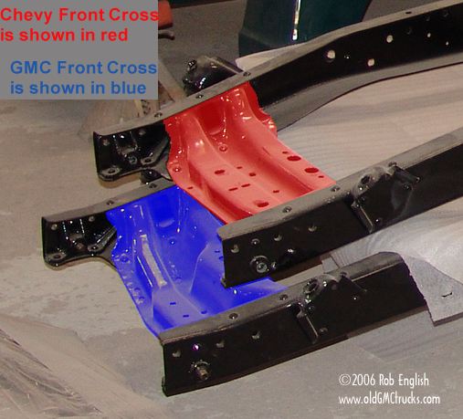

I have a 49 1/2ton and some sort of brackets, or what I thought was a crossmember, was cut off the frame in the front. I thought it was the engine crossmember, but I cant find any good pics of the front half of these frames, or find a diagram of how the factory motors mount. Help?

The truck front motor mount is the upper right assembly - the top on the front mount assembly is the leftmost part in the illustration.
The Chevrolet truck frame's front cross member is at the top of this photo.

Oh, I didn't know about those plates, but knew there had to be some sort of plate for the front. Thank you. So how about the rear?

The rear mounts are on the bell housing

Ah ha! That's EXACTLY what I was looking for! Great pics! Thank you!
