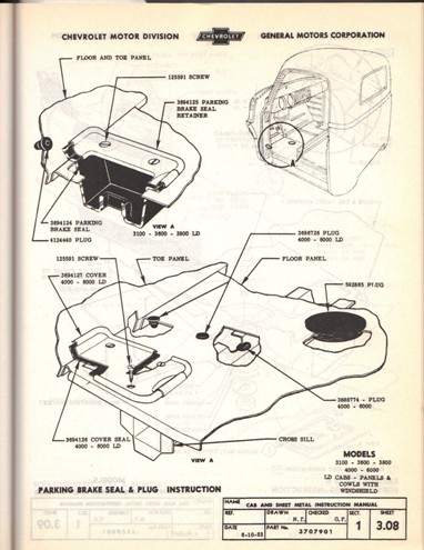

Can anyone tell me what this grommet is for that is installed on my original toe-board in my 1951 suburban ? I cut the bad areas of the floor pan and toe-board out on the drivers side.The grommet sits below the lower inner fender well bolt.This grommet has a hole in it but not all the way through.

Answer. My book shows it as a "plug".
http://www.bunchobikes.com/floorgrommet.JPG

Thanks for taking the time to link the picture.Is that in the shop manual or the assembly manual,Ive got both.I didn't even think to look in them.

Assembly manual. Section 1, sheet 3.08.
