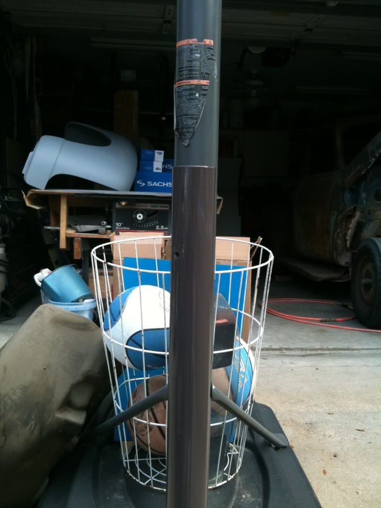

I just painted a few parts with Rustoleum #7754. The match is suprising better than I had hoped for. The sprayed color has the purple hue (not evident when looking at cap). I plan on letting the paint dry several weeks before hitting with 2k automotive clear. I hope the paint will not lift.
Posts: 1,997
Big Bolt Forum Co-moderator
Posts: 1,997
DavidF,
Since I am just learning, is suppose to thave a purple hue?
1948 Chevy 2-Ton
I also used #7754 for steering column, steering wheel, and shifter.
It is not a match at all for the original paint, but close, and a nice contrast to the #7272 I used on the other interior parts.
This is rattle can, and work for me. I was not going for a trophy winner but a daily driver.
Here is a pic with camera flash
...pic...
...sunlight...
...shade...
I also found the #7754 did have a purple-ish hue.
Good Luck

I found mine on the shelf at ace hardware, Justs as Denny points out
...pic...
...pic...
This was a few years ago

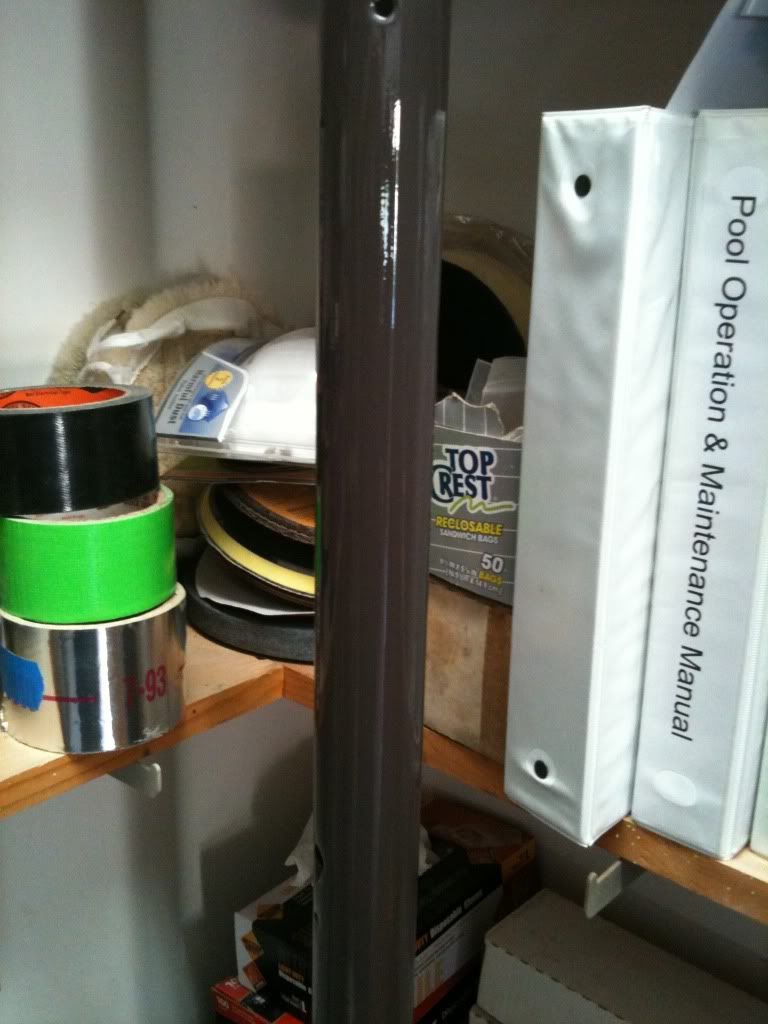

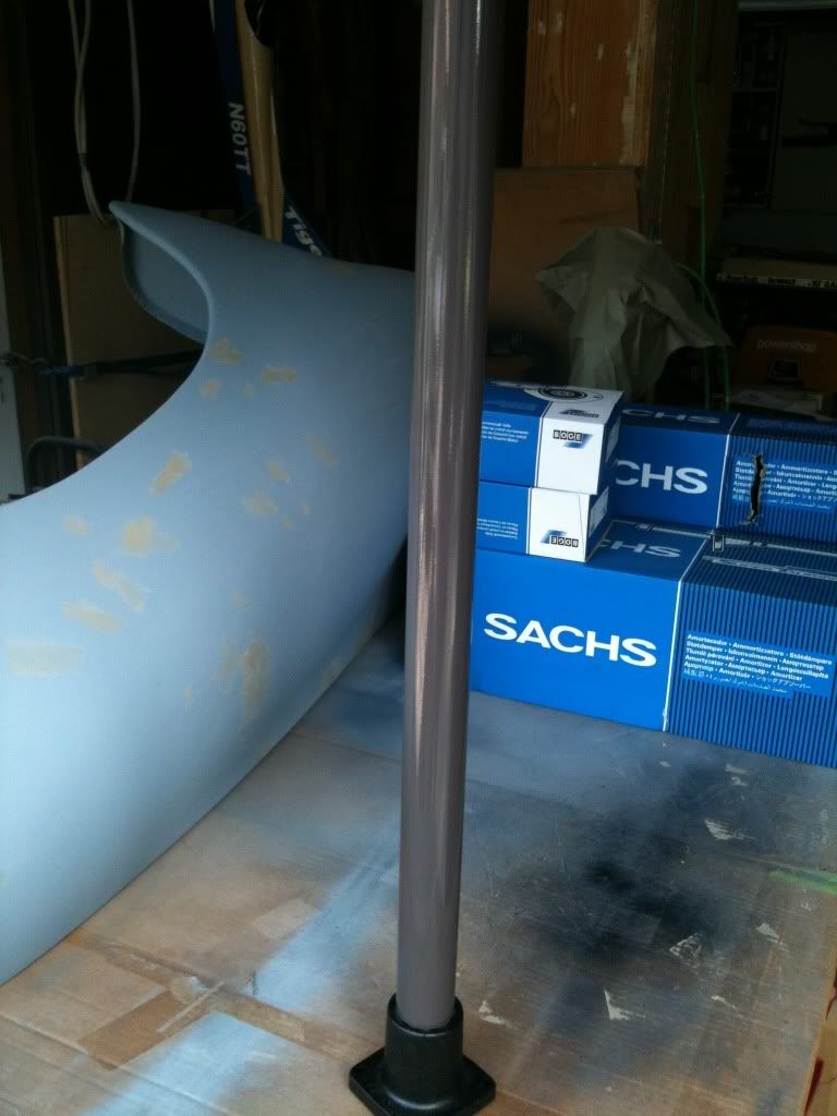

Well, I clear coated the parts with 2k urethane clear and it came out terrific. Only one small problem: While the upper shifter bracket was hanging on the coat hanger to cure, I knocked it off onto the floor and messed it up. Have to start over with that piece...ugh, I hate it when I do stupid things....
Any pics of your results?

I do, but they are terrible and dont do the part justice. The light and camera were both bad.
http://i979.photobucket.com/albums/ae273/dframe3/IMG_0909.jpg
http://i979.photobucket.com/albums/ae273/dframe3/IMG_0908.jpg
http://i979.photobucket.com/albums/ae273/dframe3/IMG_0907.jpg
