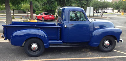

So, we finally finished the three-year restoration and most of the shake out issues were corrected. I took the wife for a ride to the grocery store and that's where we got the photo shown here on the Gallery page.

By the first of July, 2014, I was happy to say: "It's finished!" I found I was a little sad at the same time. Doing this kind of stuff is therapy for me and a way to get out of the house and doing something. After it was over, for a few days, I found myself pacing inside wondering what to do.
It did turn out nice, not 100 point perfect, but perfect for its intended purpose. Probably only I see the flaws.
