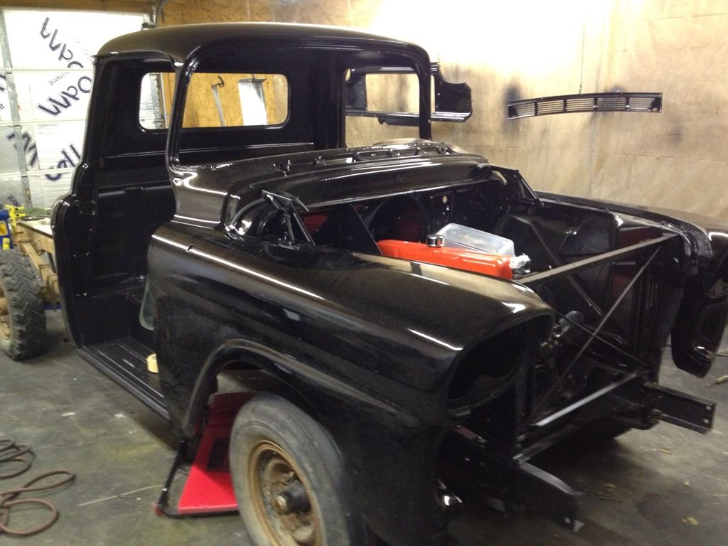

I am happy to say that I am within a couple of weeks of being able to work on the TBI again. Truck is painted and being reassembled. Front clip is nearly installed. Next will be the windshield and hood.
Progress shot:
[IMG]http://i1130.photobucket.com/albums...-B8B1F940A34B-14736-000013659EF0A527.jpg[/IMG]

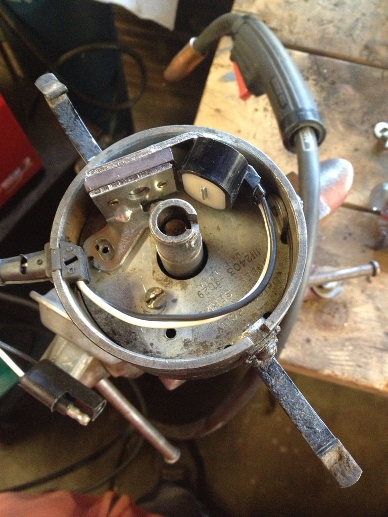

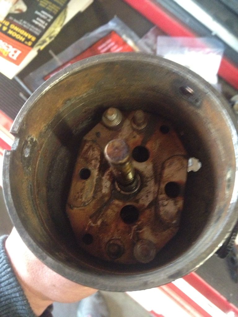

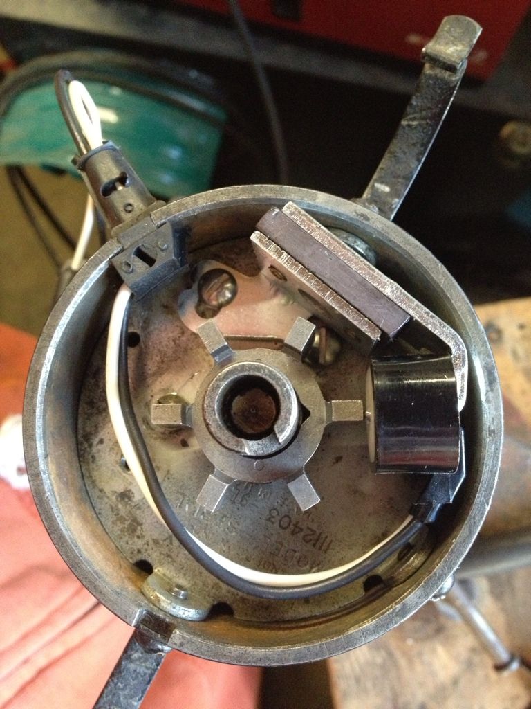

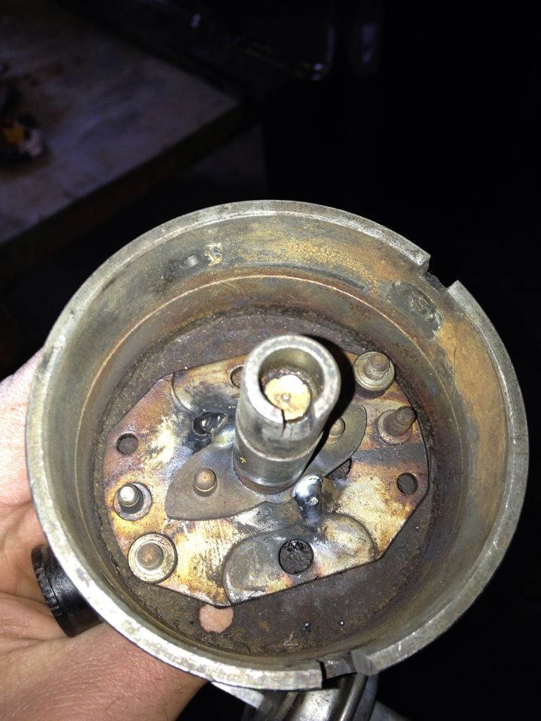

Kevin,
I think we talked off line but just to cover your options.
1. You can use the HEI GM distr. The mech adv gets locked down. the vacuum adv simply gets disconnected. If no vacuum it doesn't move.
But the rotor/reluctor phasing still needs to be set. You can do this by rotating the vacuum adv plate in the direction of the shaft rotation until the phasing is correct and then drill and tap for a screw to retain in place.
2. You can use the HEI distr that is sold on ebay and perform the same conversion. The distr is made for your engine so all you need to modify is the mech adv and the phasing.
3. You can use your stock distr and perform the conversion I have outlined in the injection forum on binderplanet.com
You can use the mopar or the ford magnetic/VR pickup and reluctor.
I have performed the conversion on the IH 6cyl delco distr which also can be swapped for the GM HEI distr so i know it is almost identical to your stock distr.
I have also converted the studebaker 289 delco and a couple others.
You can not, however use your stock distr or any other distr without performing the required modifications to enable full timing control by the EFI system.

Joined: Jan 2012
Posts: 43
Joined: Jan 2012
Posts: 43
Both ford and AMC used the ford duraspark distr on their 6 cyl's so the reluctor from either can be used. Just look up an early to mid 80's 6 cyl.
You need to check the ID of your distr. If it is the smaller delco then you are better off with the mopar pickup mounted on the stock baseplate and then your choice of a mopar or ford reluctor.
The mopar reluctor has a larger ID then the ford.

kjhibbs #910051 01/09/2013 11:40 AM
Joined: Jan 2012
Posts: 43
Joined: Jan 2012
Posts: 43
I should point out that for those reading this..... the same distr mod can be performed for use with a carb.
Just leave the mechnical adv operational, although hopefully you have cleaned and lubed and set the proper adv curve.
Then when done you simply grab a GM HEI 4 pin ignition module and mount it on a small heat sink like a 1/8"x1.5"x5" piece of alum and bolt it to the coil hold down bolt.
Connect the distr leads to the G and W terminals and the coil + and - to the other 2 terminals.
I recommend a later GM TBI coil or the ford TFI coil for a little boost.
You will now have the same ignition as the big cap GM HEI for about $20 in junkyard parts.
Best part is all the parts can be found at any store or junkyard unlike some of the aftermarket ignition swaps.
The pertronix works but if it goes bad you are stuck converting back to points while waiting for your replacement to come in the mail.

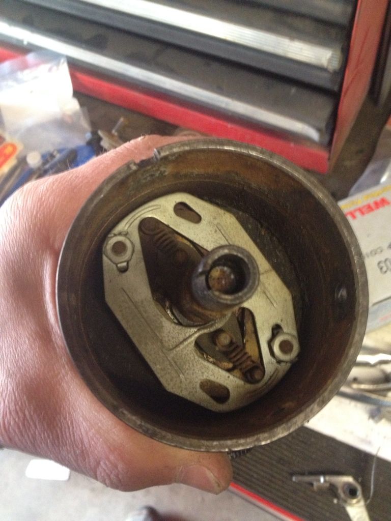

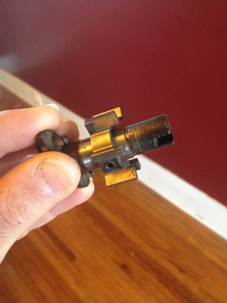

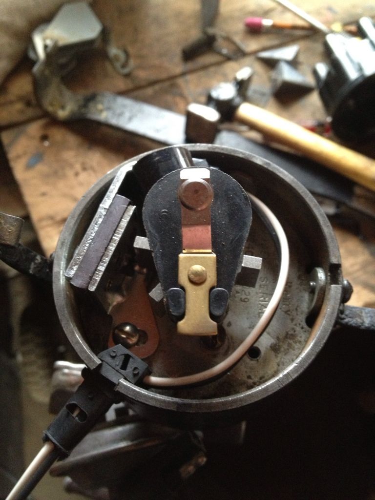

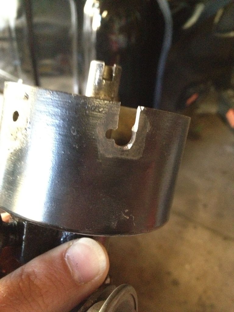

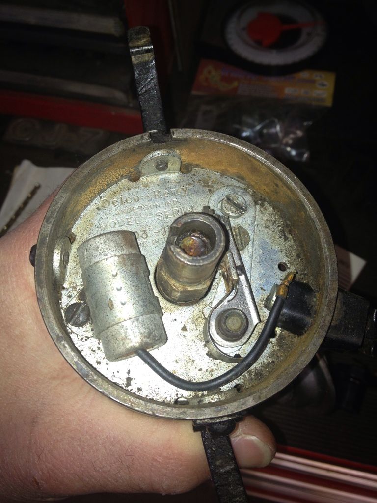

Got to work on the truck a bit more this morning, and more specifically I got to focus on TBI stuff. All of the harness reworking that I had done from the donor TBI vehicle paid off as I began to hook things up. I got a bunch of it connected and bundled. I will put wire loom over all of it when it is done. [IMG]http://i1130.photobucket.com/albums/m537/kjhibbs99/Apache%20Rebuild/7D9F71EB-390C-4E9A-A87D-ABB6DDB7D571-4928-000007D9C847A300.jpg[/IMG] I also got my parts from Rocksuto today for the distributor conversion. I will start that soon.

What should the air gap be between the reluctor and pickup?
I have been making good progress on the dizzy.
Points hole cut for the pickup wiring:
[IMG]http://i1130.photobucket.com/albums...-43B3ADFEB4DD-13442-0000161C9C9BA227.jpg[/IMG]
Shaft tac welded in:
[IMG]http://i1130.photobucket.com/albums...-EA43B876D99D-13442-0000161CA8FB9C12.jpg[/IMG]
Pickup in place with holes drilled and tapped:
[IMG]http://i1130.photobucket.com/albums...-EE1ED85380C8-13969-0000171C73FB0432.jpg[/IMG]
Reluctor and pickup installed and waiting to set the air gap between the two:
[IMG]http://i1130.photobucket.com/albums...-6B7D2DB29CEA-13969-0000171C53BA37F0.jpg[/IMG]

Joined: Jan 2012
Posts: 43
Joined: Jan 2012
Posts: 43
It's looking good Kevin.
The normal gap is .008.(brass feeler gauge)
But with these old distributors I try to just set them as close as possible without them touching.
I push on top of the shaft towards the pickup to take the play out and then set the gap.

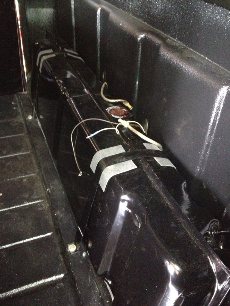

Alright, the gap is set and I believe the phasing is correct. Here is a shot of the finished product:
[IMG]http://i1130.photobucket.com/albums...93-7998-00000BAEB2D5DC21_zpsc5a2fcf7.jpg[/IMG]
And the gas tank installed:
[IMG]http://i1130.photobucket.com/albums...41-7998-00000BAEBDD055EF_zpsd4e5b60a.jpg[/IMG]
I do need some advice in finding TDC on a non-running engine so I can appropriately set the timing with the dizzy. Any thoughts?

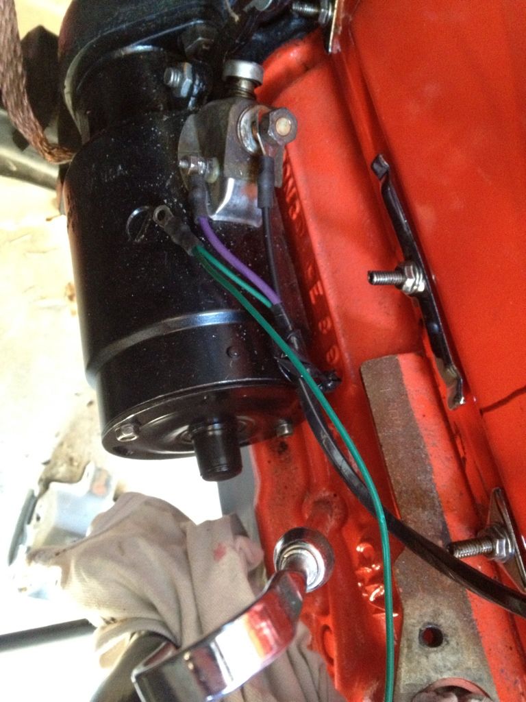

Joined: Jul 2011
Posts: 114
Joined: Jul 2011
Posts: 114
Originally Posted by Bill_USN_1
Quote
Goes to the small terminal of the starter(solenoid)
Quote
Since I have the foot starter, where would I connect this?
Connect it to the small terminal on the solenoid that the foot switch wire connects to.
Quote
Also, what is the best place to get my 12v when the key is on?
I design all my stand alone EFI harnesses the same, The battery 12V should come straight from the battery post on the starter solenoid. That means the GM main red wire that becomes org once it goes thru a fuse. See my step by step FAQ that addresses each connection.
For the 12v switched this is the pink with black and is 12V coming out of the power relay. For this you should have the battery 12V going to the relay on pin 30 for a bosch relay, and then to energize the relay(s) you should use the 12v wire that used to go to the +pos side of the ignition coil. If you had a ballast resistor then use the wire prior to the ballast resistor so you get the full 12v.
I know this was from a while back, but this is what I am working on now. I do have a ballast resistor, so do I basically remove it from the system now and go directly to the 12v switched? Here is a pic of what I have. Notice the green wire, it is supposed to connect to the starter motor resistor terminal and then jumps over to the + side of the coil. But I don't think I have the s terminal on my starter. Anyone?
[IMG]http://i1130.photobucket.com/albums...17-5897-0000077784694E98_zpse5847841.jpg[/IMG]

Joined: Mar 2005
Posts: 1,636
Joined: Mar 2005
Posts: 1,636
Full 12 volts.
