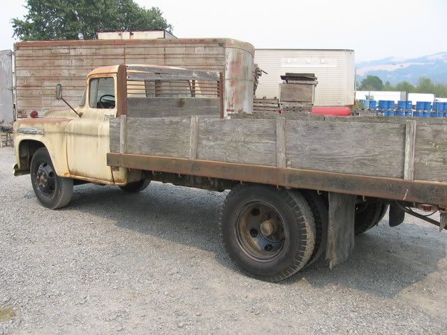

Here is my 59 Chevy. My grandfather bought the truck new to use in his orchards after trading in the old '49 dodge flatbed. My grandfather ordered this truck like he did every other vehicle he owned. Bare bones. He used this truck in the fields hauling prunes, pears, apples and walnuts until 1969 when he sold all of his property to developers and started trucking cement. From 1969 to 1984, it hauled a cement blower until the front end got so worn out it would shimmy like a bastard going up the road. My dad and grandfather pulled the front axle out of the truck and had it rebuilt, but shortly thereafter my grandfather died of a heart attack. The truck sat in the storage yard my dad rented for the trucking business until 2007, when my dad died. I decided to put the truck back together and just drive it. It has been a fantastic truck, but ive had to stop driving it as the 261 burns more oil than gas. dang
I just recently bought a 64 chevy 1 ton cab and chassis with a good running 292. I am going to pull the motor and swap it into the viking so I can drive it and part out the rest.
The plan right now is to just get it back on the road and do rust repair (above windshield, cab corners).

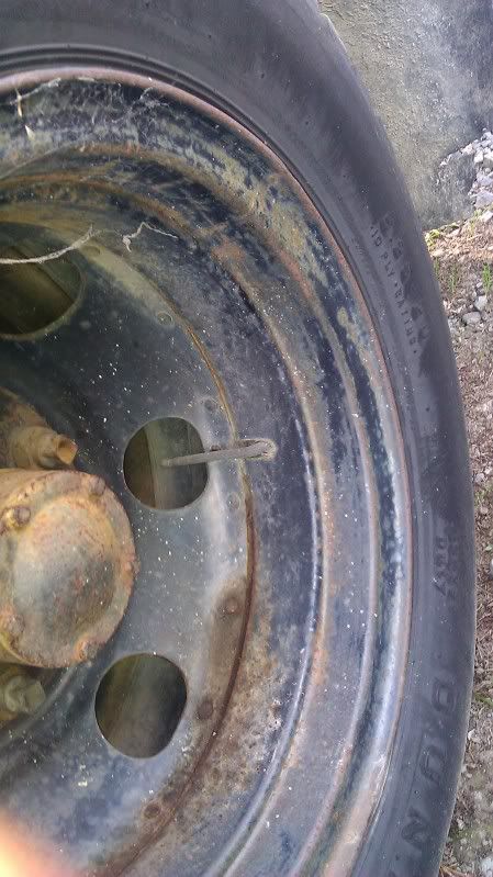

Also, after really looking at the truck today I noticed I had the rims that come apart in the middle. These are the original wheels that came on the truck and have only been taken apart once. (the truck is only on its second set of tires since my grandfather bought it new. The tag for the tires is in the glovebox). Are they acceptable to use? Or should I look for new wheels?

Posts: 6,214
Posts: 6,214
red58,
The Clark Transmissions were only used on the 70 & 80 Series trucks. The 60 Series (which oldtek88 has) used the New Process and the 90 & 100's used the Spicer transmissions.
oldtek88,
Those rims are the "widow makers" which should be replaced with either a lock ring 20" tube type wheel or a 22.5" tubeless wheel.

The easy to figure out if it is a Clark or a New Process is by the shift pattern. A Clark will have 1st away from the driver and toward the seat and reverse away from the driver and toward the dash. A New Process will have 1st toward the driver toward the dash and 2nd right next to it. Also a New Process has 4 positions toward the dash and only 2 toward the seat while a Clark is 3 and 3.
As for the wheels, it sounds like you have the Firestone RH5° which are the dangerous kind.
