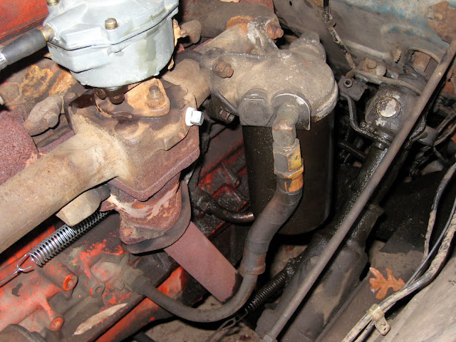

This engine has two hoses coming out of the thermostat housing. Normal looking bottom half, top half has a hose coming out the pass. side then another half-sphere lump on top of it where the rad. hose comes out.
Oil filter mounting flange is part of the lid, looks to be aluminum and has three ports 1-in & 2-out. Is this a good one?
Carb. is not one I've seen before. 1V with the bowl forward like a carter but not rectangular, more rounded "D" shaped. Quite a few plumbing fittings coming off of the intake vacuum port.

DADS53,
Here is a photo of the 58-63 261 oil filter assembly (the filter head/top/cap is as you describe, I think).
http://lh3.ggpht.com/-tkTLlRE_wHA/Svjv70H3yOI/AAAAAAAAABk/sVobcFpGa24/s640/IMG_4359.JPG
That is a full-flow filter - the only factory full-flow GM filter used on cars/trucks (Chev & GMC) in those years.

Yup, that's it.
