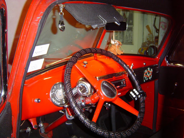

Originally Posted by fredoly
Joker, how was the clock problem solved? Ed
Look on the sun visor bracket in his pic.

lol,
I have another high tech clock in my hot rod
can you find it

The sun dial in the middle of the hood???

lol..for sure a lot of sun in the pix..
the watch is on the floor just in front of the gear shift..
looks much classier in real time...lol
