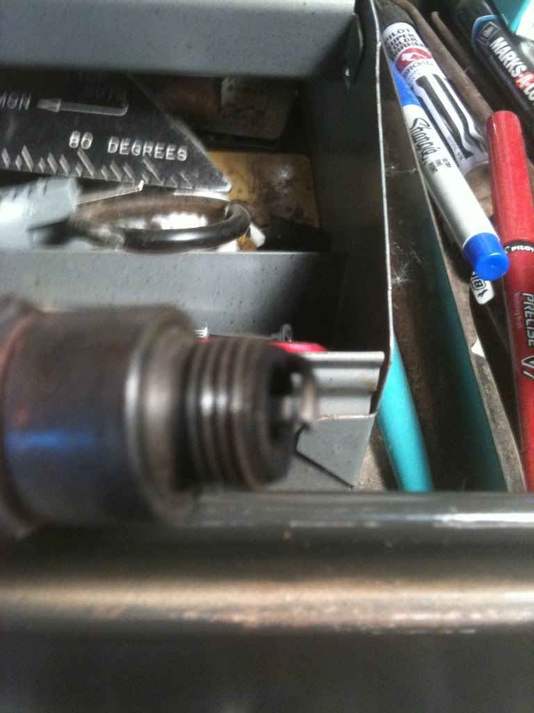

what do your plugs look like?

51 Ashton... here's a pic of a plug. Looks like the tip of the plug is whiteish

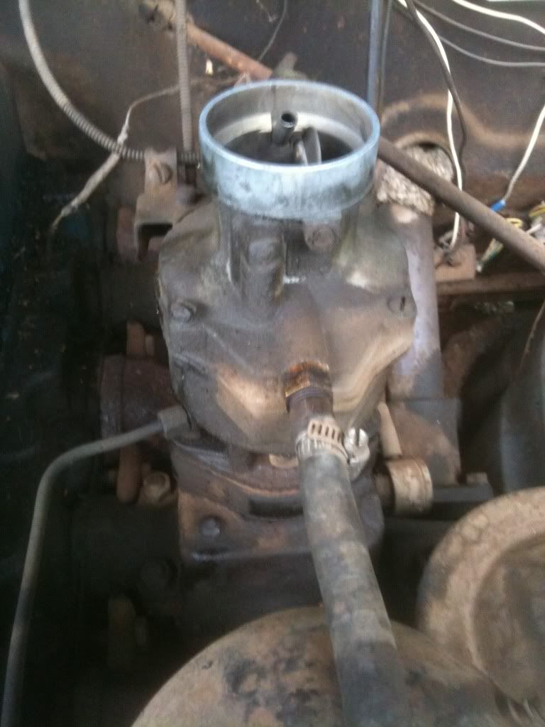

Yeah, it's a Rochester. I can read "ROCHESTER," printed diagonally, with BP above and GM below... this is on the front of the Carb. On the back, with a flashlight and a mirror, again I read Rochester GM Carburetor, and a bunch of smaller print that I can't quite read. I've never messed around with the carb at all. Maybe it's time I get a rebuild kit? Or switch it out for a Carter? Again, this is on a '54 235. Here's a pic:

Yes, model B Rochester.
Besides the base gasket I would also make sure your vacuum advance is working.

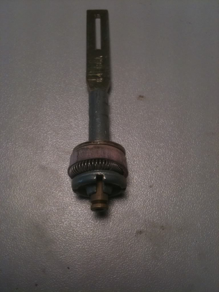

The carb is now rebuilt! I think I found the culprit - the old pump plunger has a leather seal around it, which is no longer properly in place (see pic). The rebuild kit came with a new plunger and seal - will check my mileage. Hoping the replacement part will make a difference.

Dramatic results.... can't be sure because gas pumps are not all the same, but this time I filled the tank, drove 40 miles, filled it up again (same gas station)....only took 2 gallons. I don't believe I'm getting 20 MPG, (I was getting 10), but even with a big margin for error, mileage is greatly improved. I will have to do a more scientific test, but I'm happy with the results of the rebuild! Thanks guys, for your tips and advice.
