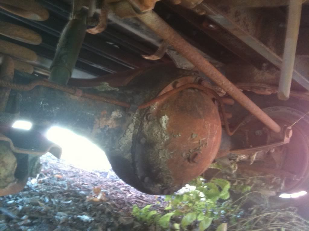

So I may have found the rear end. I just want to confirm, as the cab and bed is not original. He told me that he bought it complete and was unable to get a title and scrapped the rest. It was a '72 3/4 ton, Cheyenne special, with a big block v8 and th400. He indicated it was all original. It has the round domed pumpkin just like my '49, and a coil spring rear end. Its half buried in the dirt, but I counted 10 bolts.
I guess before I lay down the cash for it I want to confirm with those who know much better than I whether or not it is the 4.10:1 that I seek. Link below to the photo of the picture:
http://i422.photobucket.com/albums/pp303/jongersbach/Rear%20End/IMG_0906.jpg
Thanks

Oh Yeah,
It,s definately a HO Series rear
question remains is it a HO 52 or a HO 72 pumpkin.
Cant tell from the pics.
Are the wheels/lugs an 8 pattern?
If they are it,s the right ham.
Now the question remains,what ratio is it.
Get the cast #,s off the case and get the stamped #,s off the Case.
Regards,
steve sr.

Steve, so if I get the #'s, what am I looking for? My studies show that both the HO52 and HO72 rear will work, correct? I pulled up the '72 manual and it stated that with the big v8 and auto tranny, it is either a 4.10 or a 3.54. I hope it is the 4.10, because the 3.54 I believe would swing to the opposite side from where I am currently with the 5.14. The 4.10 would be ideal.

NO that wont work!
I asked the question of HO 52 or HO 72 rear because of Lug patterns and tonnage.
HO 52 is 1/2 ton 6 lug bolt pattern since Christ was a Corporale till about 1972.
HO 72 is the style rear you need in a certain year,because you can pull your axle shafts and pop out the old ham, and then just Slide the axles back in.
regards,
steve sr.

I thought the HO52 was in 3/4 tons, and the HO72 in one tons? This rear end is a 3/4 ton, so it should work then, correct. Its a decent price, and the guy is pretty good to work with. I think if I help him to pull it, and it wasn't right, that he would work with me on finding one that does. I just want to be right before I go through the effort of pulling it.

You are correct. And the pumpkins are interchangeable.

Picked up the rear end, and opened up the cover and counted ring gear teeth. 41 teeth. Couldn't get to the pinion to count, so I removed the 3rd member (gonna have to anyway) and still can't get to the pinion to count teeth. The 4 bolts that hold the pinion in place, if they are removed, and the yoke and pinion come out, do I have to set the gears back up?
Looked for stampings on the ring gear - found the following:
10:41 GM and 3 71. It is from a 71 chevy, so perhaps the 3 71 is a date stamping. Can anyone derive anything from the other stamping? Here's to hoping that it can be derived from that and that 10:41 translates into 4.10:1. Thanks

Is it possible that you miscounted? I think a 4.10:1 will have 41 teeth on the ring gear and 10 on the pinion.

Update. there are 41 teeth on the ring. This is what happens when an aggie trys to count!
So, would the 10:41 stamped on the ring gear give me the pinion/ring teeth count? 10 teeth on the pinion, 41 teeth on the ring gear....I guess I was looking at it as ring/pinion. They stamped it pinion/ring. Sometimes it helps to just stand back and draw it out.
So I just got lucky in the scrapyard and got my highway rear! Sweet. while i like driving 40 in my old truck, 55 may be better, and the motor will appreciate it as well!
