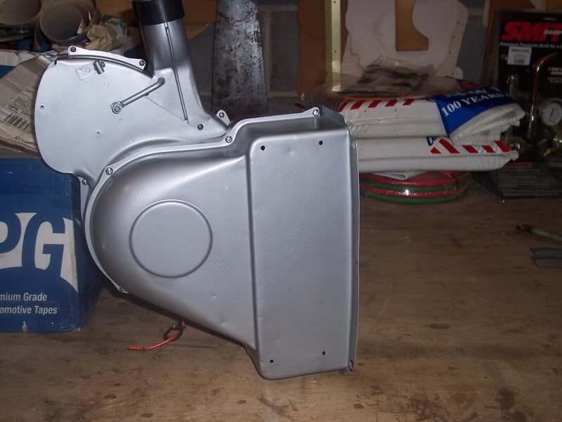

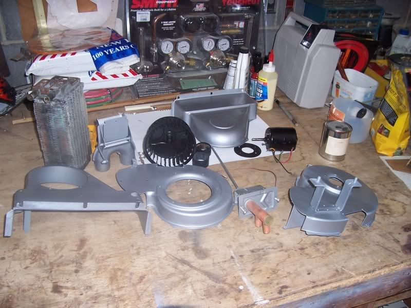

| | | | | Joined: Sep 2001 Posts: 29,269 Bubba - Curmudgeon | | Bubba - Curmudgeon Joined: Sep 2001 Posts: 29,269 | Stickler, Earlier discussion about this heater, You'll most likely will have to post link_s to pictures in order to be sure that people are posting advice that is appropriate for your heater. The recirculating heaters did/do not have a "water control valve". | | | | | Joined: Aug 2001 Posts: 1,299 'Bolter | | 'Bolter Joined: Aug 2001 Posts: 1,299 | Recirculating had a round heater core and the fresh air or airflow had a more squared heater core. | | | | | Joined: Dec 2001 Posts: 14,522 Moderator: Welcome Centre, Southern Bolters, Legion Hall | | Moderator: Welcome Centre, Southern Bolters, Legion Hall Joined: Dec 2001 Posts: 14,522 | STickler, If its a Harrison H-02-47 it sounds like its like mine. My heater has the same numbers on it and is what I think is called the Fresh Air Heater. Does your heater look anything like this. This is my heater....I haven't put the new decal on the front yet http://i140.photobucket.com/albums/r19/LutherParris/52Panel/000_0177.jpghttp://i140.photobucket.com/albums/r19/LutherParris/52Panel/000_0191.jpgWhat you heater has...or don't have may be the work of some previous owner. You have to look for tale tall signs something may be changed or just done awasy with. | | | | | Joined: Nov 2001 Posts: 1,517 'Bolter | | 'Bolter Joined: Nov 2001 Posts: 1,517 | There was someone trying to sell one of those heaters to a member here a while back....LOL
| | | | | Joined: Jan 2010 Posts: 4,263 Shop Shark | | Shop Shark Joined: Jan 2010 Posts: 4,263 | H-02-47 pic Deves heater pics I have that same heater in my 50. With firewall mounted ranco valve. That model heater may not have been used for your year truck. Check e bay under harrison heater or chevy truck heater. A post on the parts wanted section of this forum may help also. Good Luck

| | | | | Joined: Jan 2011 Posts: 9 New Guy | | New Guy Joined: Jan 2011 Posts: 9 | Bolters, First off, thank you everyone. And sorry for my steep learning curve and not quite correct questions.
My heater looks like achipmunks, only rustier and dirtier - thanks so much for posting the pics. So it's a Fresh Air heater I am in search of.
