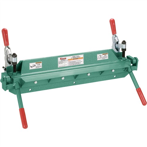

WHat about a seamer for folding the metal over the door edge?
'nother misnomer - what you need is a sheet metal brake to pre-fold the edge of the patch piece - or do it by hand starting the bend over a hard straight edge with a hammer

The door bottom panel I have already has the edges bent. They are just at a 90 degree angle. I'll need something to bend them over the edge of the new door bottom to create the seam. Also, when cleaning up the edges so I can butt weld the pieces together, what works to remove the rust (my door is basically pitted and painted with rust)? How about the protective primer on the new door piece?
