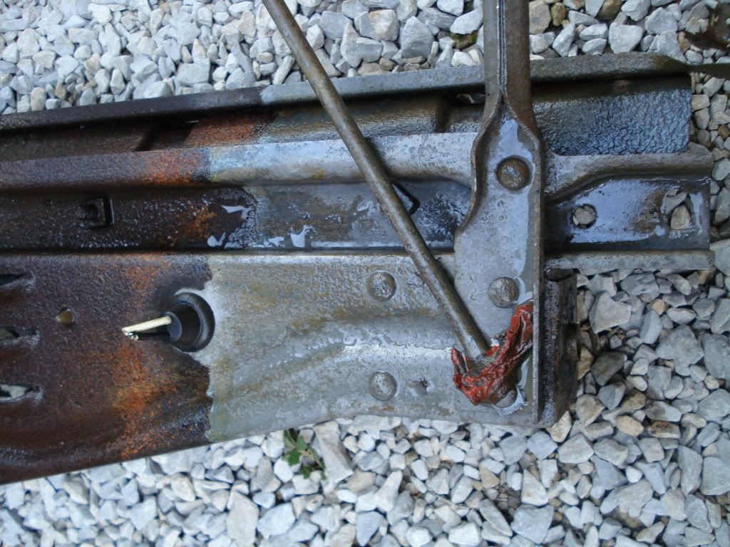

I had muriactic acid ( from my pool) and tried that just to see how well it worked. I was really surprised at how well it turned out in the end. The attached pic was my test item, i just sat it in a tupperware container for about 3-4 hours just to see what it would do.

also note Josh, muriatic acid is hydrochloric acid and while it is stable on it's own, use it with personal safety uppermost in mind, contaminated with other common household chemicals, particularly bleach, it can give off mist fumes very corrosive to lung tissue

O yeah you definitely want to be very careful with the stuff and DEFINITELY wear a respirator, I mean they use it to etch concrete after all haha. I just bought a blast cabinet and will be using it for all of my parts, Im not a big fan of having a vat of acid sitting around my shop..
