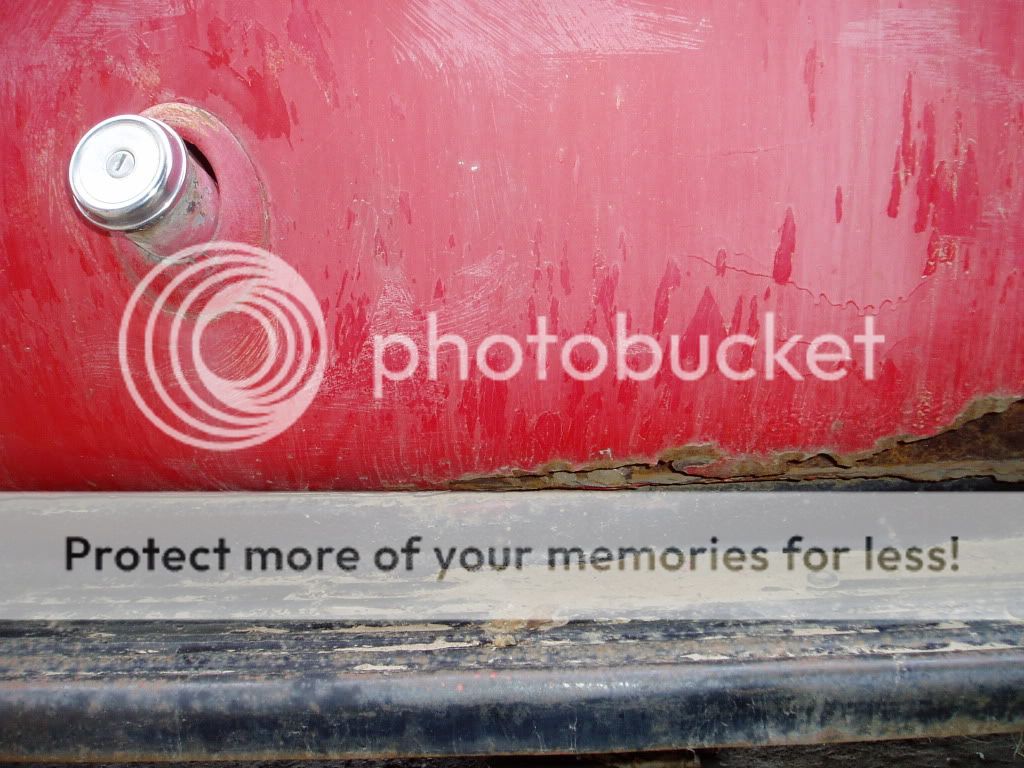

has anyone used door skins to repair the rocker panels on a 1952 gmc? i would like some feed back before i buy 39" chev pick up door skins repair patch's for the 49" rocker panel between the doors and the back fender.
when i look the radius seems the same but i would have to spend 59.00 to find out i am wrong.plus shipping.any advise would be helpful as the drivers side is very bad and also has the exhaust pipe on that side. when i drive i do not want to fill the cab.

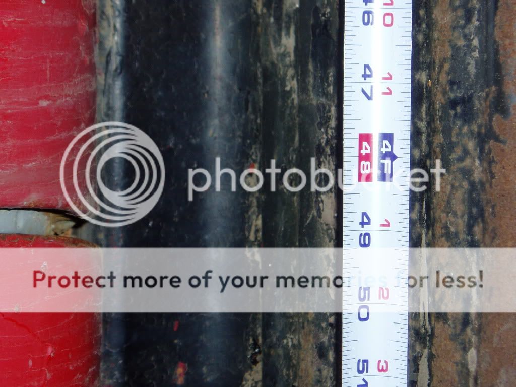

sorry about not being clear. the pick up door skins are 39 inches long and 9 inches tall and i need 49 inches long and 9 inches long of metal for behind the door to fender for my panel. i will buy two and stitch them together for length if the curve is correct.

well gentleman. i bow to your knowledge and appreciate your advice. in all the pictures that i have seen, this rocker panel did not look like it was the right one. maybe shadow or my eyesight. i would gladly buy this part if it was 49 inches long. my one ton needs 49" long panels not 43" but if i have to stitch the 39" door skins then why would i not just buy two and stitch the 5 " i need one to one side. thank you for letting me know that this rocker panel is the right one.i will place an order shortly.i am so new to this that all the help you new friends have given me is above and beyond.

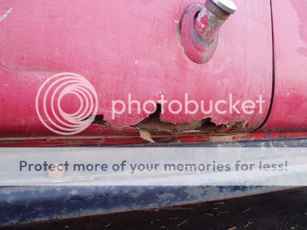

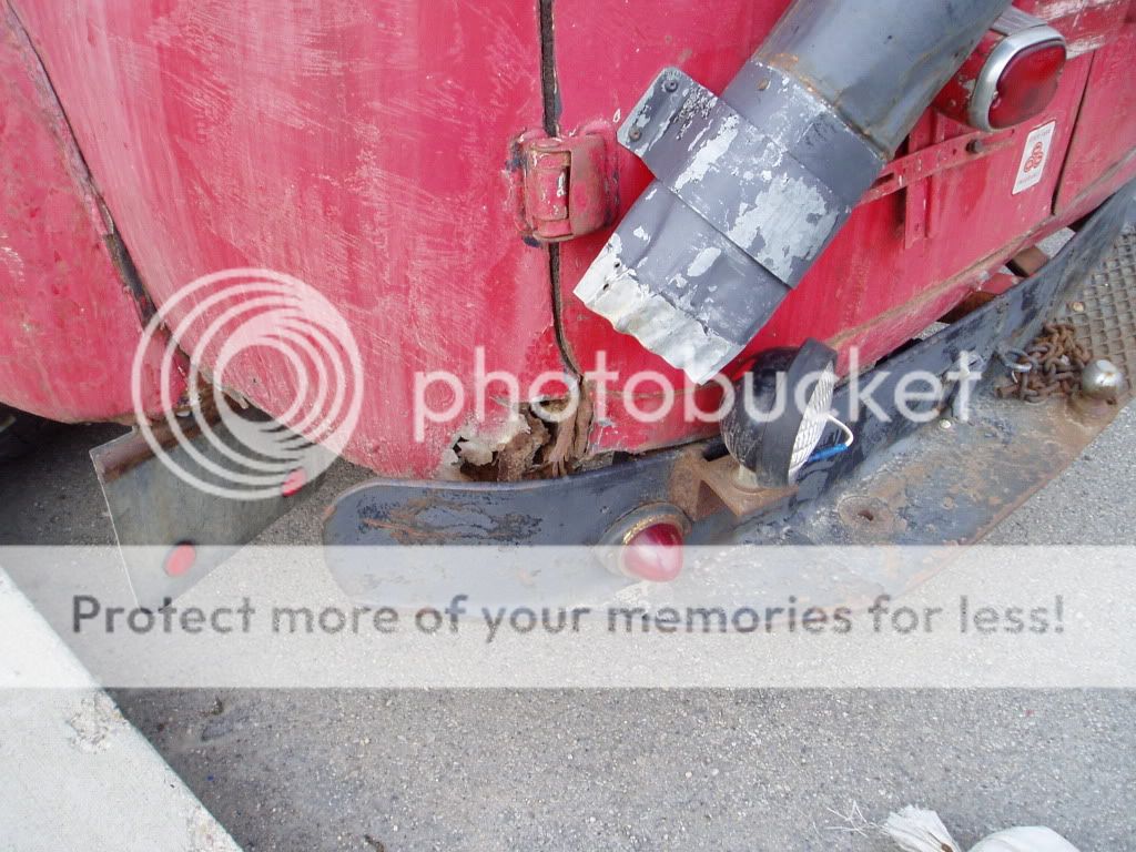

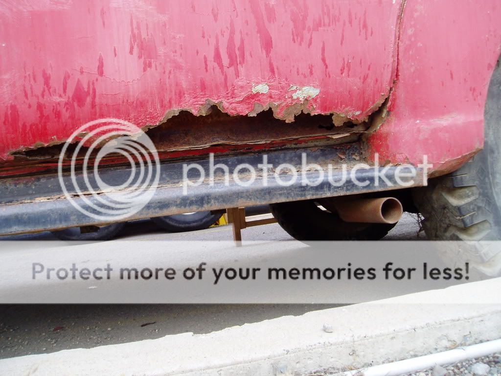

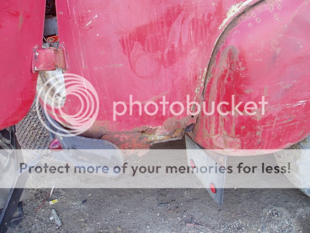

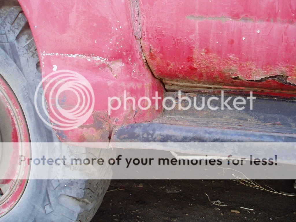

ok please let me know if the skins are thinner then i may have to stitch two to make one. problem is i need both sides. i will try to post new pictures of the rust areas and any suggestions will be appreciated.

Links don't work but here's the deal. The cab on your 1-ton is the same as a cab on a 1/2 ton. The rockers that I linked to are correct for your cab.

I think there is a misunderstanding here. The word "rocker panel" is being used here but I think you mean rear quarter panel. Now if I remember correctly, the outside rear corner panel for the truck cab goes from the door pillar back. You could use this panel along with a lower door skin to get what you want, I think.

Aha, a panel-body panel problem.
(I missed this -> the title of the thread is "door skins for 52 panel")
Regular cab panels of of little usefulness.
Outer door skins are supposed to be a good replacement (but, you are correct to see if you can get a reply from someone who has done this).
Jim Carter has panel-body panels made by Ray Stanley.
(Or, contact Ray directly)
