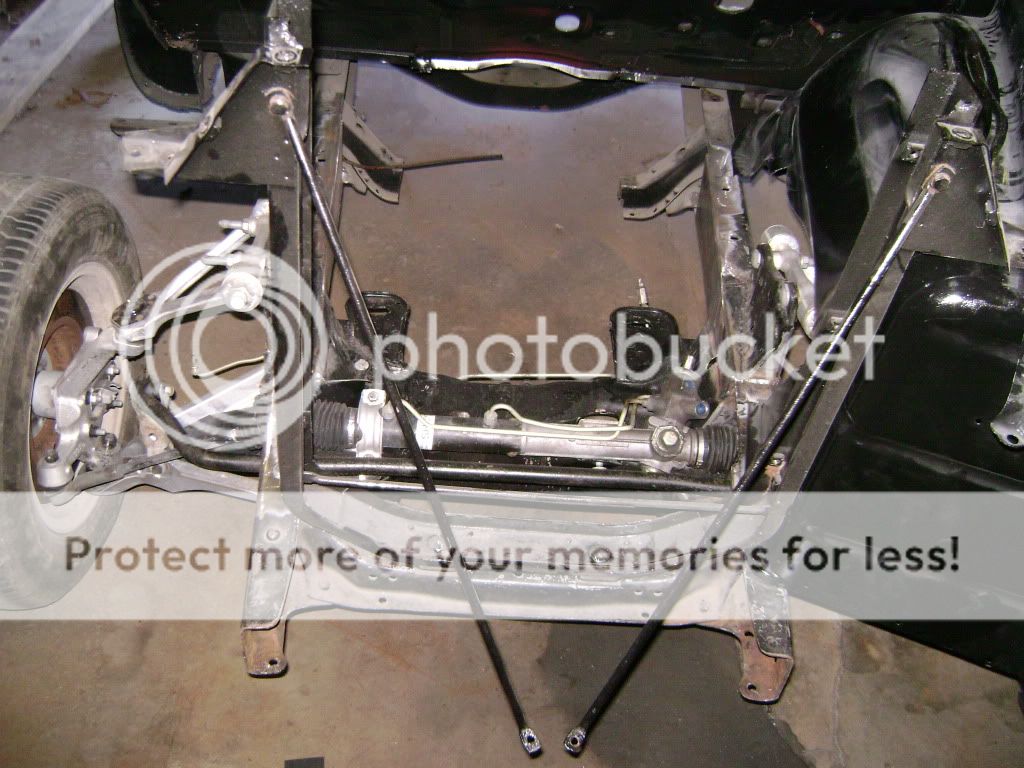

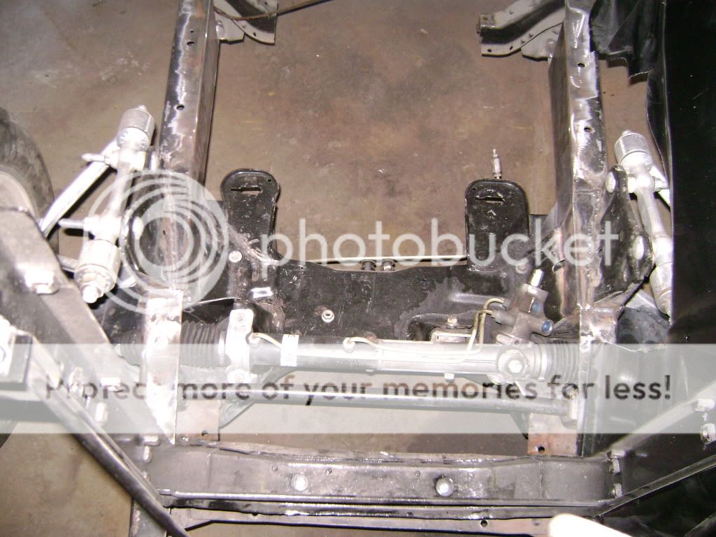

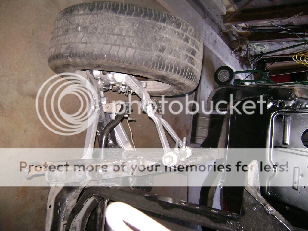

I wanted to update the post on my truck. I got the front end in with the help from you guys on dimensions. I'll post pictures this weekend. It looks great fit pritty good, I had to cut the front half of the frame off to get the sway bar in there. But everything went pritty smooth.

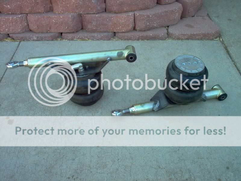

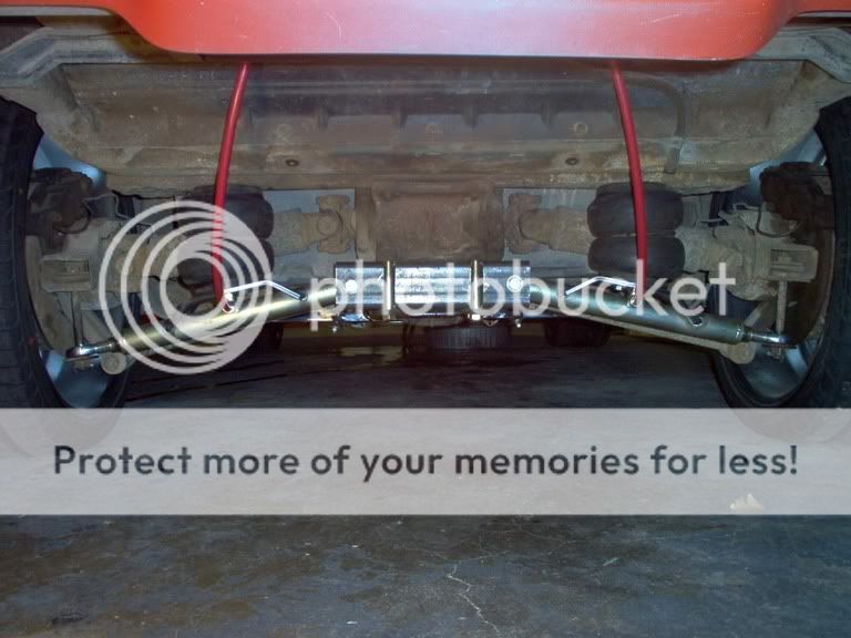

The other thing I was thinking about doing is getting rid of the leaf spring and doing some sort of air bag setup on the rear. I don't want to do any sort of valving but just the bags to give me some adjustability. I'm not to confident in the single fiberglass spring holding the truck up expecily if I haul anything. It's not like this is a work truck but I want to haul something. I know the easiest way is to buy the air over shocks but I'm to cheap for that there like $400 a piece. I have found some picture of the low riders cars and truck were they make a mount of the rear diff were the original spring goes and then some arms to the knuckls and put air bags on top. What do you guys thik about this idea? Anyone done this?

I was wondering how the ride would be. I have had sevral muscle cars but have never drove a corvette so I was un sure how stiff it is. What do you think about the air bag idea? I like the adjustability of the air and when I want to through a load in I can just pump them up. Plus there like $80 each for 2500 lb bags.

Here is the front end.

I would consider that rear setup very poorly thought out.
http://i1020.photobucket.com/albums/af322/dreasoner/bags2.jpg
Heim joints are not designed for side forces like that. The air bags are also in the wrong location. The air bags will have to exert three times the pressure than they would if they were on the ends of the trailing arms.

I know that is not the best design but I like the concept. If I go this route I would do something different than the heim joints, something like the end that is on the differential side and then a flex joint off the spring pirtch. Then move the air bags as close to the fram as possible. maybe something off the top of the knuckle were the sway bar mounts. Thats a more solid point than the eye hole were the OE spring hangs.
