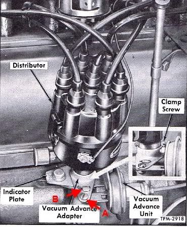

I found the rivet that holds the vacuum advance to the stamped metal piece clamped to the distributor had elongated its hole. This allowed the distributor to advance and retard uncontrolled a couple of degrees. Ended up drilling the rivet out, re-drilling the hole to make it round and using a 1/4" shoulder bolt.
I had two spare distributors and both were worn the same way, I’m wondering how many others have found the same problem

Hey Kip,
I assume you are talking about the rivet pointed to by arrow "A" in this picture http://i824.photobucket.com/albums/zz168/dinlow/1953%20GMC%20before/Distributor.jpg. I know this shows a screw, but its a picture of a later model distributor. Is that correct?

Dale:
Yes the rivet is the one at "A" When I held the distributor cap and rotated it there was a degree or two of rotation before the link to the vacuum cylinder began to move. I'm kinda surprised that the rivet and the bracket to the distributor base are not hardened in that area. It seems there is a lot of ware as this area rotates slightly every time the vacuum advance moves, and that happens every time the gas pedal is moved in either direction. It is also the only thing that holds the distributer in place.
