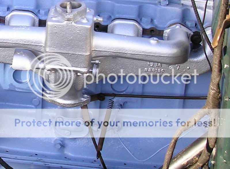

Here's a pic of the manifold side of my 216 - http://i360.photobucket.com/albums/oo45/dalbuie/41%20Chevy/216.jpg - my petcock is on the right of the engine (looking at the pic).
If you can point out where yours is leaking form on this pic it should help.

Its the hole inbetween the freeze plugs Im new at the photobucket stuff I hope this works. http://i835.photobucket.com/albums/zz276/hdstickel/1953%20Chevy%20Engine/IMG00046.jpg

Are you sure that's a 216 ? My 1951 216 has only one hole and the bell crank stud is screwed into it.
My 1954 261 has the two holes as yours does.The bell crank stud is screwed into the boss closest to the rear of block.I had to screw a plug in the other hole,I don't remember what size of bolt.

i just got my 59- 235 back from being rebuilt on thursday. after looking at your pic and looking at my block, the hole(front one) is for the stud that holds your throttle linkage. mine is 5/16'-18. that stud screws into the water jacket of the block. i took mine out with some effort and cleaned up the threads and it was tight going back in. i chased both the stud and the hole with my tap set and it screws in all the way with ease. with all the years of crud build up the treads just need to be cleaned up.

The hole mentioned is used for the throttle linkage on my 216 - but my 216 doesn't look the same as yours.
The 216 I have only has the one whole the same as bowtietim. I think the early 235s were also low pressure babbit engines, what's the block number on yours?
