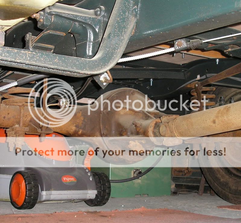

Hay Dalbuie:
With that long bed yours looks like a ¾ ton. Does it have an open driveshaft (with an exposed universal at the back)? I can not quite see it in your photos, but if this is correct look up my tech tip. With a little work you can have a 3.90 gear instead if the original 4.56. I get just over 50 MPH at 2500 with 205 X 15” tires
Additionally once you get that ’55 to ’62 differential you could get a 3.38 gear set from Patrick’s.
1941 Chevy Master 3/4-Ton
More images in the Bolt Bucket
Born to fish, the truck is only a hobby.
Joined: Jan 2008
Posts: 100
Joined: Jan 2008
Posts: 100
Hi Kip,
I've had a look at your great tech tip and will have to look out for a diff - although I think they'll be fairly rare over here in Scotland so a new complete rear axle may be the best option if I can get one that fits easily.
Any idea what would fit reasonably easily and still look stock. My first option will be to look for just the diff as that does look the best option to leave it as original as possible.
I think I have the same diff as in your pics so I must have a standard 3/4 ton.
http://i360.photobucket.com/albums/oo45/dalbuie/41%20Chevy/P6250001.jpg
Cheers
